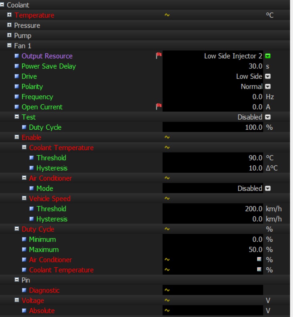

So got the car running, discovered faulty head gasket, rebuilt head and its running again. now It runs for longer it gets up to temperature but the fan is not kicking in as programmed when the water temp reaches 92 degrees. The fan works when the test is run. I'm assuming somewhere in the programming a condition is not being met but for the life of me I cannot find it.
motec coolant fan.jpg (114.17 KiB) Viewed 6215 times
any thoughts I can try.

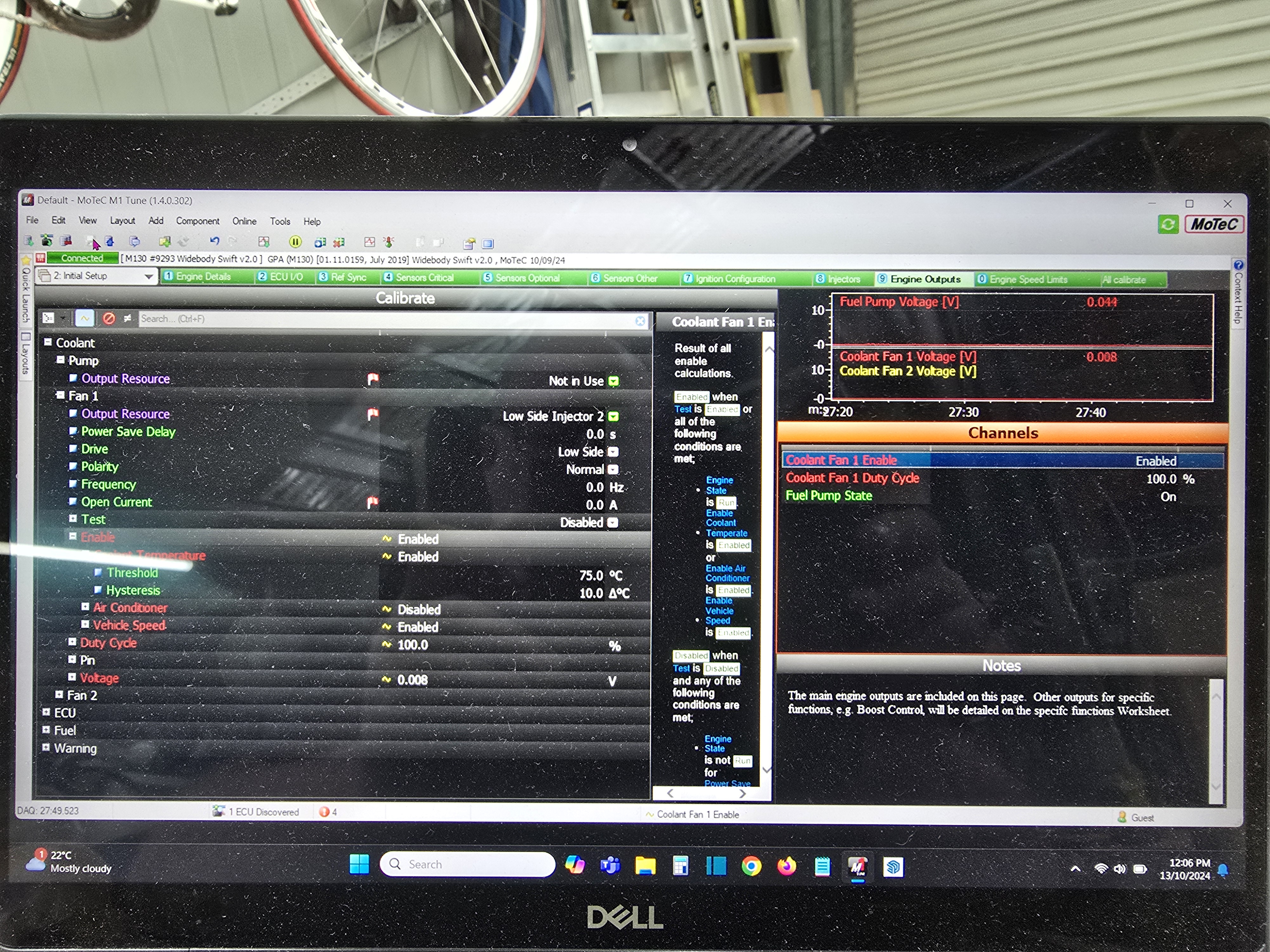

Re: Cooling fan wont start. newbie alert!
PostPosted: Sun Oct 13, 2024 1:01 pm
by David Ferguson
Can't tell, is the engine running when you took that screen shot?
PostPosted: Sun Oct 13, 2024 1:04 pm
by justineurope
yes it was running.
PostPosted: Mon Oct 14, 2024 9:16 am
by Stephen Dean
Can you post your configuration thanks.
PostPosted: Mon Oct 14, 2024 8:35 pm
by justineurope
Here it is. Pretty sure its the same as the one you sent me a while ago. I don't think i've messed with it other then trying to get fan to work. Just a reminder. using the test function the fan runs. I may have set the trigger temperature low to test rather then at near boiling.
