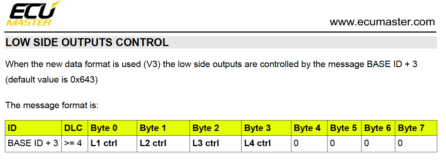

Might sound a daft question (I don't have a PDM), do I just enable the PDM on my chosen CAN (1,2,3), set a base ID (720h) & have the V3 Switchboard at the same Hex address, then choose a 'Bottle/Heater/Resource' ie a PDM Byte ? Mask ? that gives a value in the correct byte address to turn 'on' the relevant one of the four relays on the V3 Switchboard.

I'll set the V3 to base address to either 0x117h (0x11Ah -3) or 0x115h (0x118h -3) seeing as for o/p control the V3 is looking for BASE ID+3
The part I'm not clear on though is the o/p control (L1 to L4) on the V3, do Bytes 0,1,2,3 just need a value in them for the V3 to to operate the desired output?
Do I set V3 base ID to be 0x115h and set the Bottle/Heater/Relay to be Byte 0,1,2,3 ie 'Engine Speed', 'Throttle Position', 'Vehicle Speed', Collant Temp' for V3 o/p's L1 to L4

I think that it would be best to transmit the request into the C1212 and then retransmit it to the Switchboard as the message layouts are different between the two.

It depends on how you allocate the resources that are used, but the V3 can read the M1 messages directly, but there isn't a 1:1 relationship between the transmit format and the receive format. I'd have to test it properly using the one that I have, but just doing a check of the two formats you would have some of the outputs that wouldn't be controlled as their messages would overlap.
