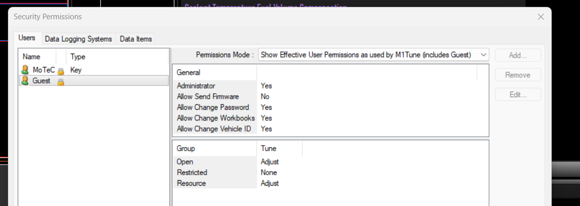

When in doubt, you can go to Tools > SHow Security Permissions
Security permissions.png (79.12 KiB) Viewed 1891 times
Looking at the triumph firmware, the guest user does not have permission to send firmware. That means you would not be able to change to this firmware without the different user key, or change from that firmware to another one from the guest user account.
