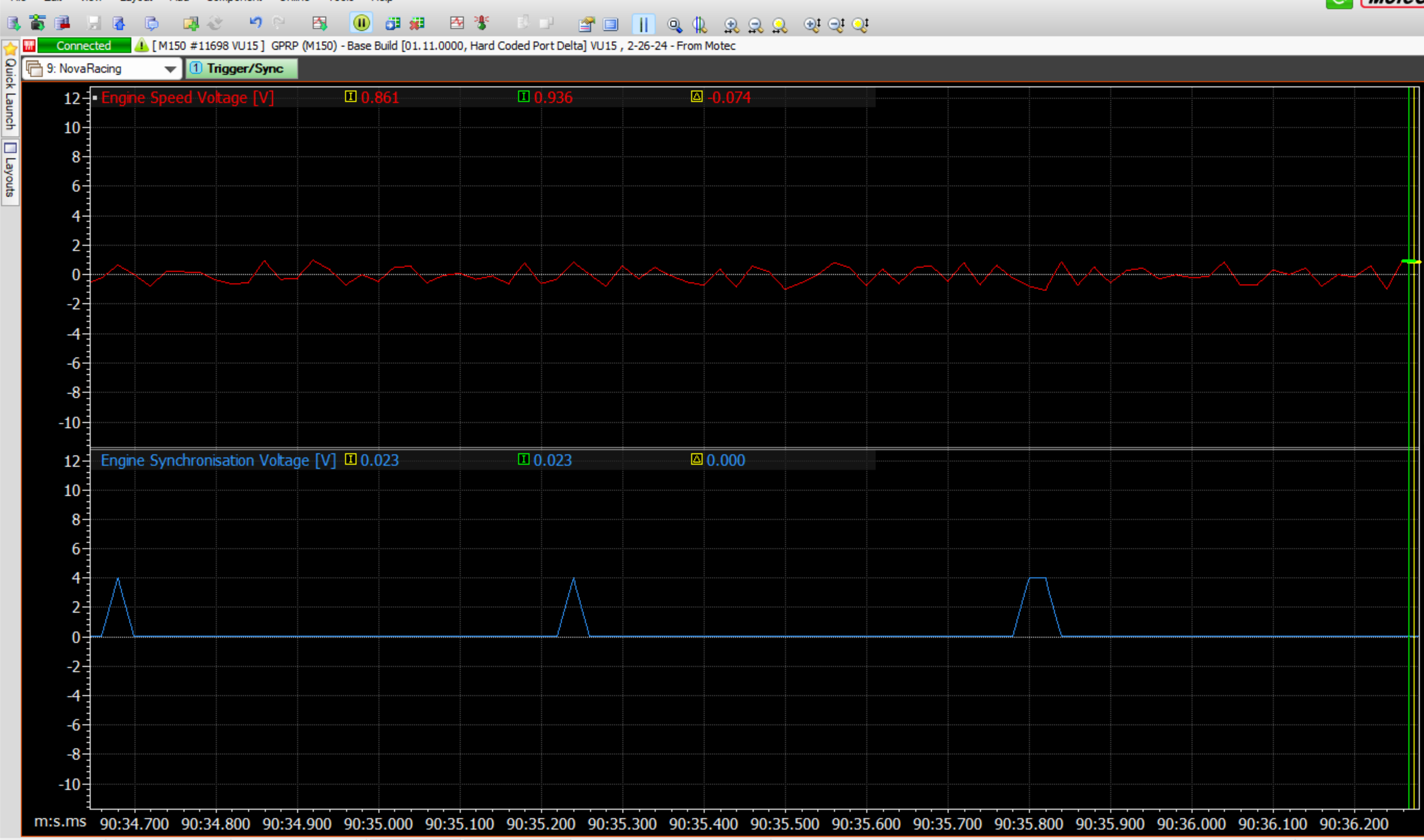

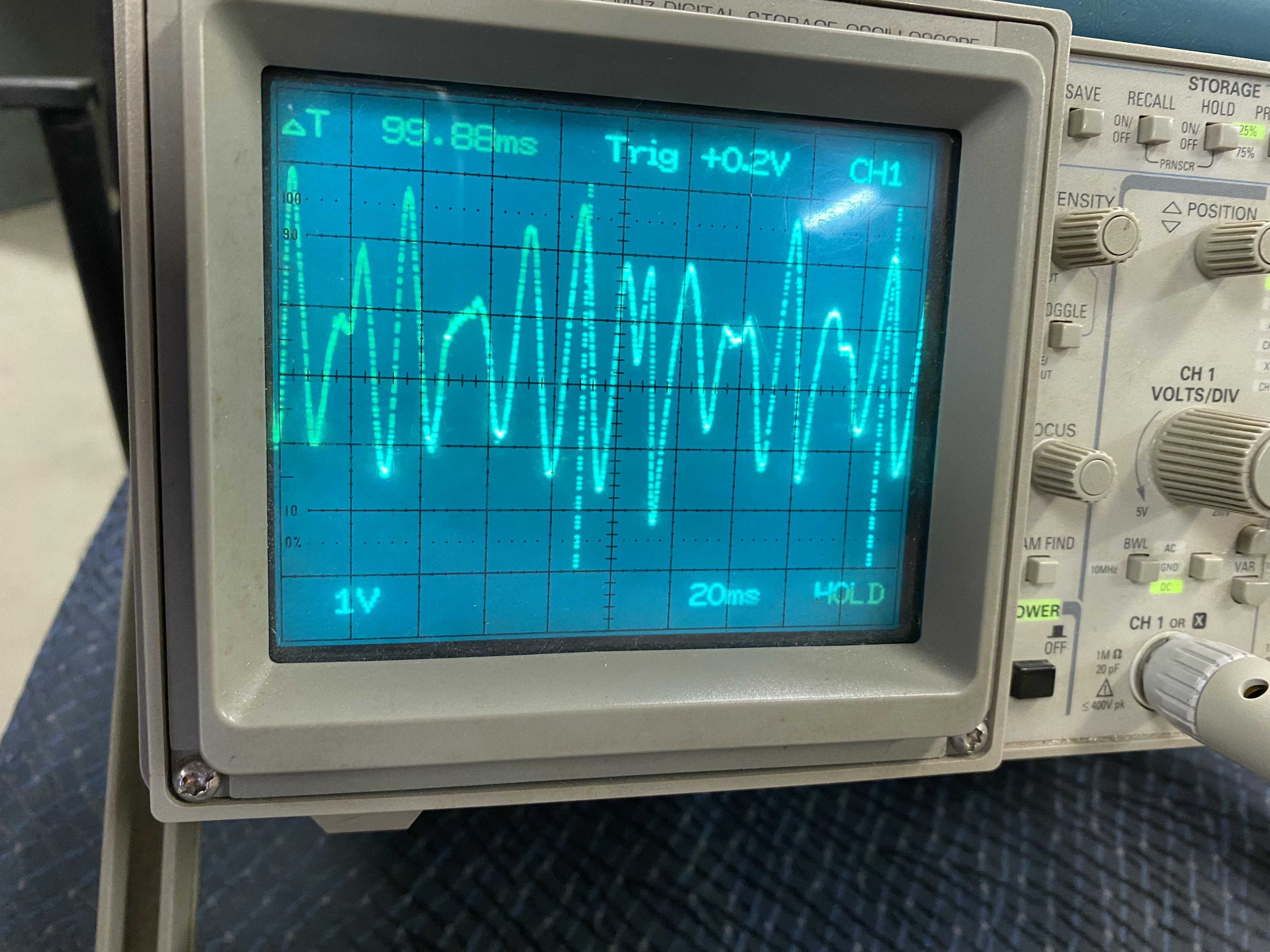

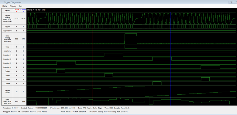

Even though we get Cycle lock, we checked our ref sync anyway and it looks very strange. We checked with an oscilloscope and it does not match at all with what MoteC is showing. We ran the engine on our old ECU two days ago and everything was fine so we don't think its a wiring issue (we use a swap-able mini harness to go back and forth between ECUs). I will attach a picture of our ref sync voltages, a picture of the oscilloscope, and a correct picture of our ref sync from our old ECU.
No real changes were made to the tune above except we enabled the engine run switch and set it to one of our dashboard switches.

Ignore the voltage trace shown in the time graph, it only updates at 50Hz and is no way near fast enough to correctly show the voltage traces. If you want to see what signals the M1 is receiving, use the Online | Capture Inputs functionality in M1 Tune.

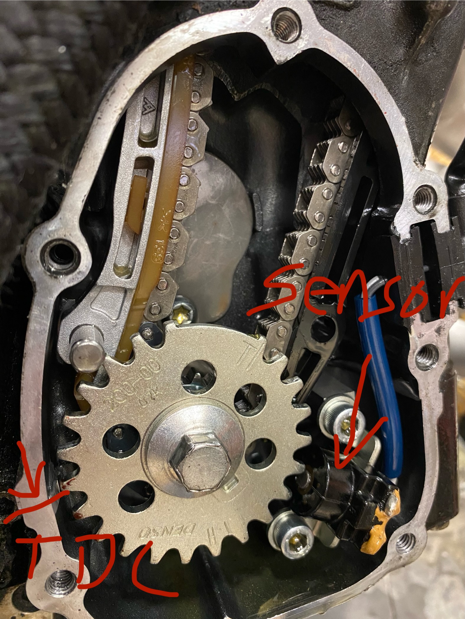

With all the fixes, we think the only remaining issue is our reference offset value. We have been trying different things for this value and we finally were able to get small sounds of combustion followed by after-fire out of the exhaust. We hear a loud pop and see flames coming out of the exhaust. This leads us to think that our timing is off.
We have a timing light that we hooked up to the engine on our old ECU so we could look at it with the engine running. We found an advance of 15 degrees on the timing light was needed to line up the TDC mark on the crank wheel to the TDC mark on the crank housing. I'm not sure if this helps us find the reference offset value. We are confused on how we can get the reference offset value and if we need the timing light to do so.
Any help or advice would be appreciated. I will attach a picture of our crank wheel with the mark for TDC cylinder 1 on the left side and the crank position sensor labeled. I will also attach our current tune which is the stock Motec Tune with our own calibrations and an input capture with the ref-sync sensors setup properly.

To get a idea of the base value for the the Reference Offset, remove the spark plugs from all of the cylinders other than Cylinder 1 and then do another Input Capture. This will result in the engine speed slowing when Cylinder 1 comes on to compression and allows you to calculate an approximate window for the Reference Offset value. You will need to use the timing light to determine the exact value.
