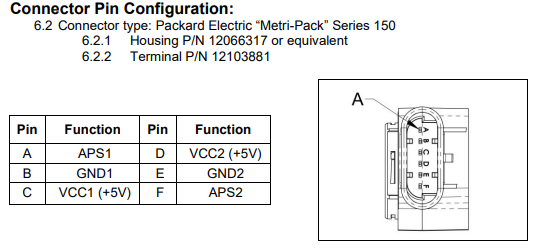

Postby David Ferguson on Thu Mar 30, 2023 4:15 am
Your Williams Controls data sheet is not for the sensor as programed in the Lokar pedal. I am trying to get you the correct data sheet, but I would think you could go with the info in the Lokar instructions -- that indicates it should work with the MoTeC DBW Pedal setup,as there are two analog voltage outputs.
Re: Help with DBW pedal
Postby David Ferguson on Thu Mar 30, 2023 5:06 am
I couldn't get a complete data sheet as the outputs are programmed for different customer requirements, but here is the pinout for 134734 that clearly shows two APS outputs.
Williams Controls 134734 pinout.png (34.25 KiB) Viewed 5370 times
Postby ZT-R on Mon May 01, 2023 11:01 am
That got it, thank you sir!
