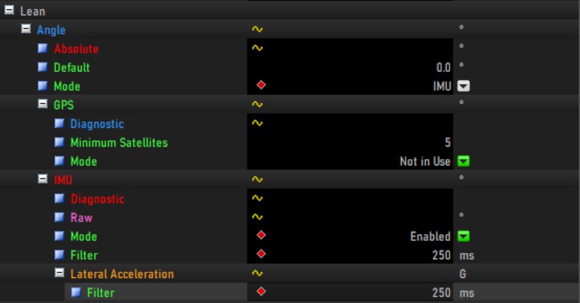

Now go back to the search bar and type Lean
Set the settings as follows:
Lean Settings.jpg (39.17 KiB) Viewed 8881 times

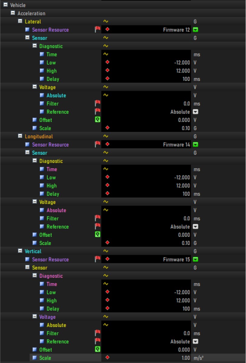

Now go back to the search bar and type: veh accel
Set as follows:
veh acceleration.jpg (115.5 KiB) Viewed 8881 times

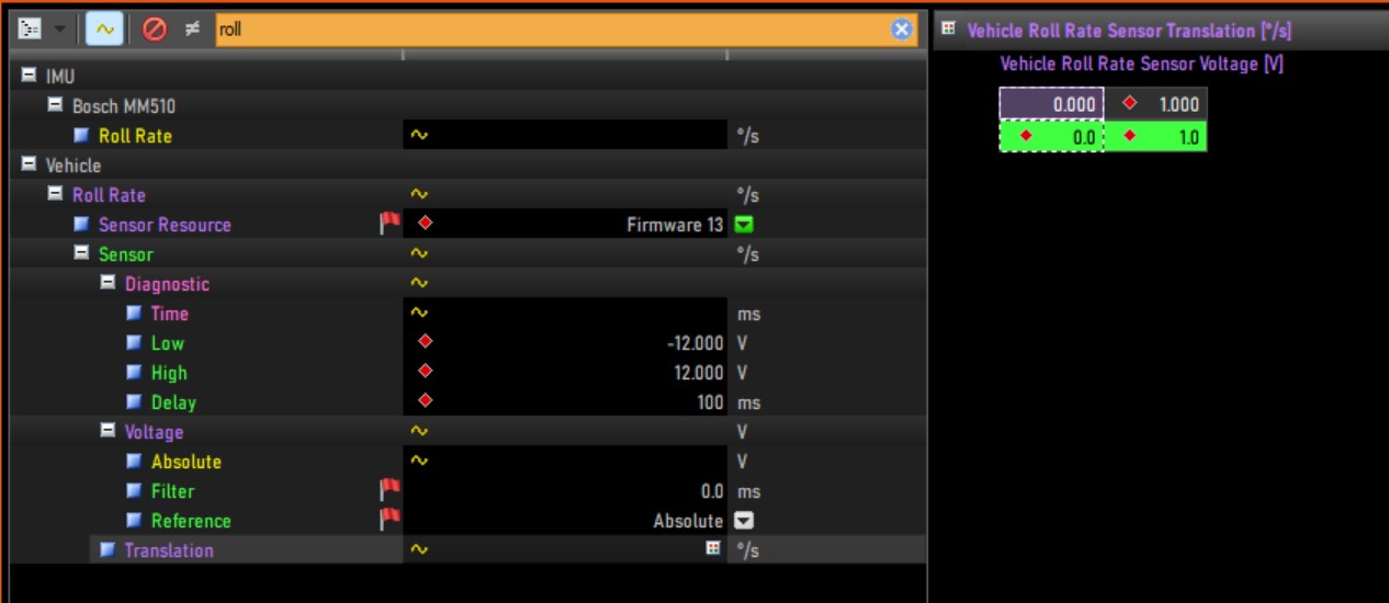

Now go back to the search bar and type: roll
Set as follows:
roll settings.jpg (75.38 KiB) Viewed 8881 times

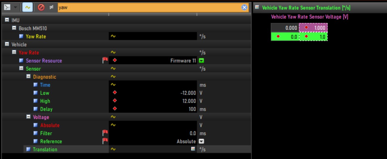

Now go back to the search bar and type: yaw
Set as follows:
That will cover you for the required setup of your Bosch IMU in your firmware.
