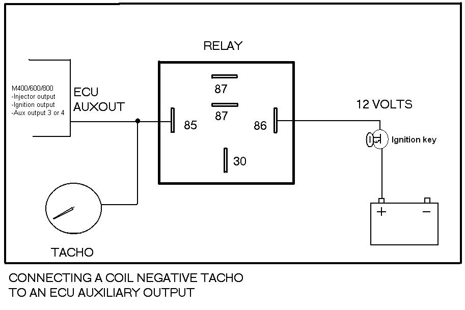

Back to the Tacho...
I have HB5 configured to be the tacho output but no response from the Tacho or RT DL1 / Dash4 Pro its piggy backed to.
I cant see any adjustments for tacho output configuration - am I missing something ?
Re: M130 OUTPUTS
PostPosted: Tue May 30, 2023 10:24 am
by Stephen Dean
The Tacho output pulls the signal to ground, so it needs to have a supply to it to do so.
This is one way that it can be done.
COIL NEG TACHO DRIVE.JPG (50.23 KiB) Viewed 6459 times
Re: M130 OUTPUTS
PostPosted: Tue May 30, 2023 2:55 pm
by Exigeman
Aha - got it - Thanks Stephen
