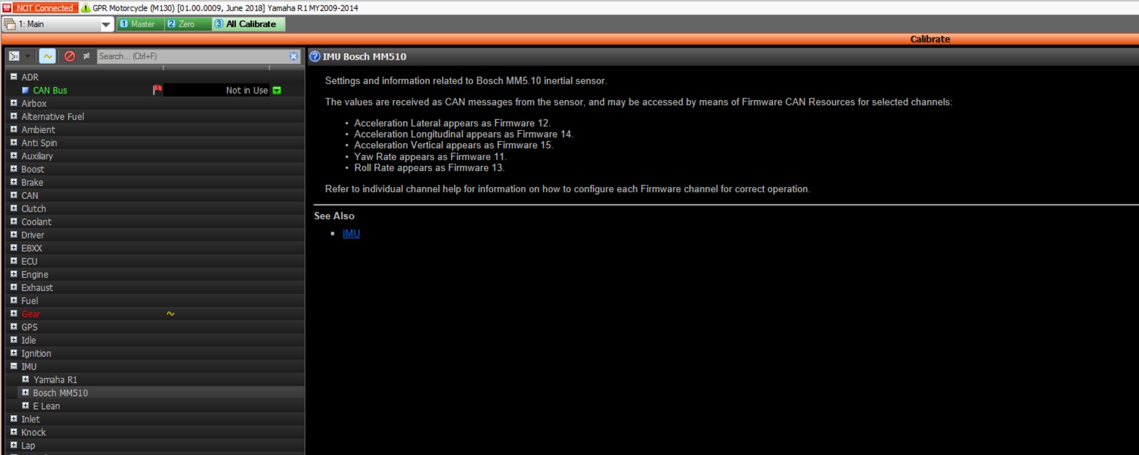

You can also navigate to the top of the tree in all calibrate and it is written in the help:
Bosch IMU finrmware channels from all calibrate.jpg (207.41 KiB) Viewed 3610 times
Once you navigate to the channel values show in the list, it even provides you with all the information you need to correctly calibrate each of the sensor inputs in the package:
