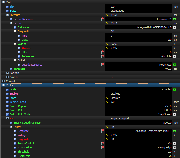

Set the Clutch Pressure Sensor Resource to Firmware 31, and move the input that was used for Clutch Pressure Sensor Resource to the Cruise Exit Switch Resource.
Cruise Control setup.PNG (46.34 KiB) Viewed 6329 times

Brad when on line to my laptop and set it all up and checked it all works.
Thank you.
