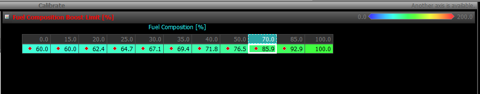

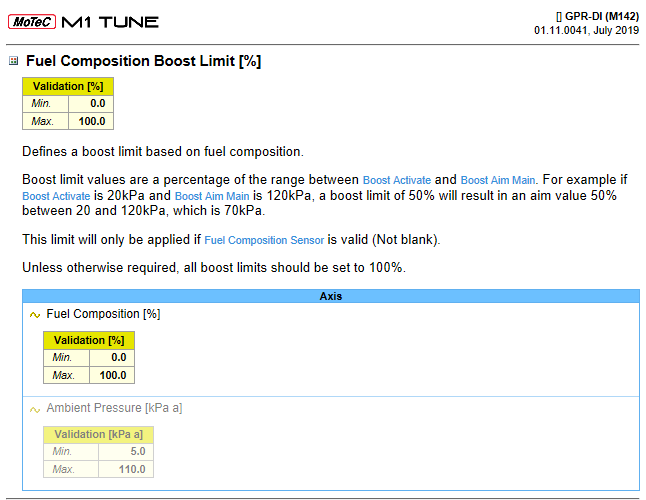

You need to have the alternate fuel mode set to flex fuel, and have a boost output resource assigned to add all the boost control systems.
You are then looking for the 'fuel composition boost limit (%)" table.
This applies a scaling between the boost activate and boost aim main.
As this table has a maximum value of 100%, you set you boost aim table to suit your higher boost fuel (high ethanol content) and use the table to scale down for your lower octane fuel settings.
