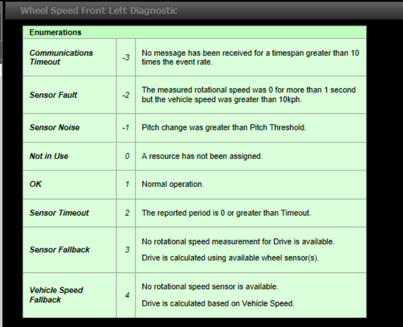

I have attached a screenshot of the diagnostics available for you wheel speed sensors in your package.
Wheel speed diagnostic.PNG (139.14 KiB) Viewed 3820 times
