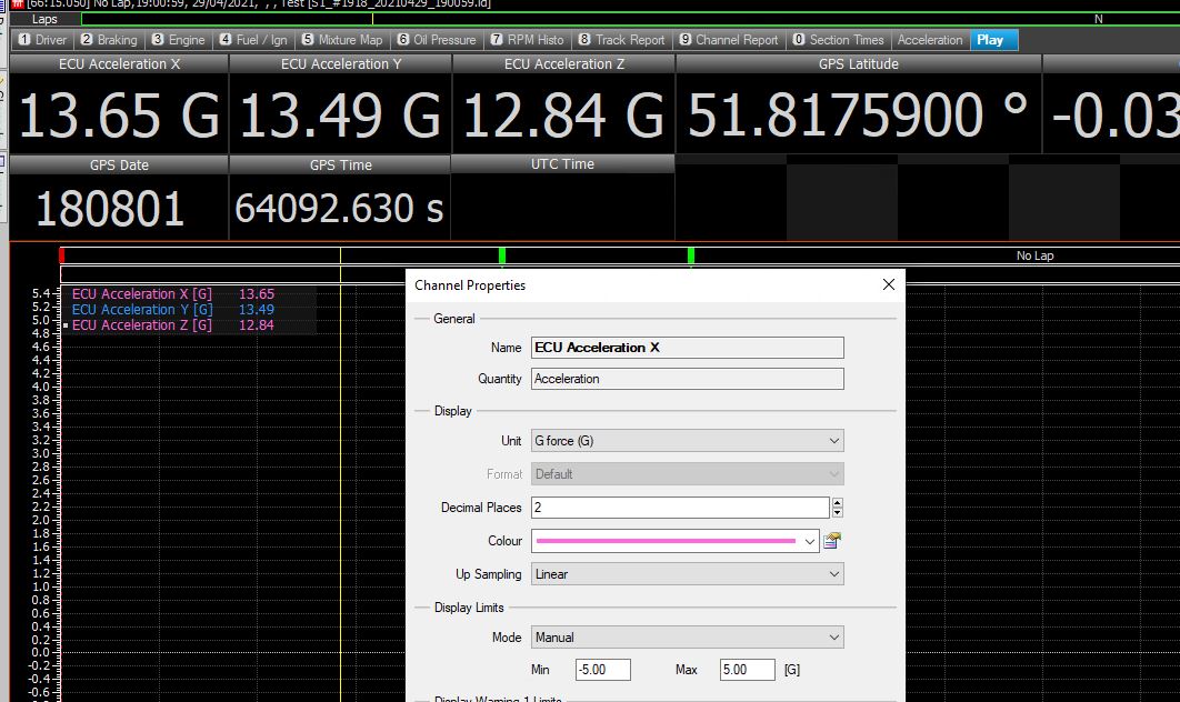

Is it possible to convert the X/Y/Z M130 acceleration sensor figures in i2 to normal G units?

In the M1 Package, what do you have the ECU Acceleration channel units set to? The default values are G, and the log files will log the files in the same units as the channels are set to.
In i2, if you click on the channel and either right click to select channel properties or use the keyboard shortcut (Ctrl+N) you have the option to change the units that the data is displayed in.

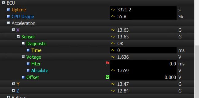

Probably better to show my problem -

by Stephen Dean
That is the voltage range that I would expect to see, and also matches mine for the X Voltage when it is sitting on my desk.
Use the Q function on the Voltage Offset, this shouldn't be at 0.00V.

PostPosted: Fri Apr 30, 2021 6:51 pm
by greenamex2
Thanks Stephen, that is my lunch break job sorted out!
