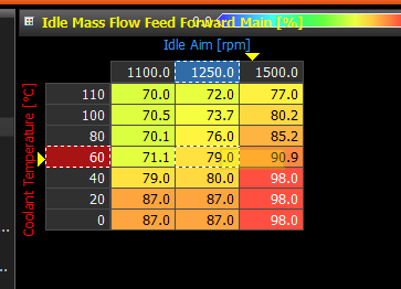

Motec idle 2.png (6.91 KiB) Viewed 4938 times
Idle Aim
Motec idle 1.png (7.42 KiB) Viewed 4938 times
Ramp rate
Feed Forward
Motec idle 3.png (13.97 KiB) Viewed 4938 times
More than 3 cells
