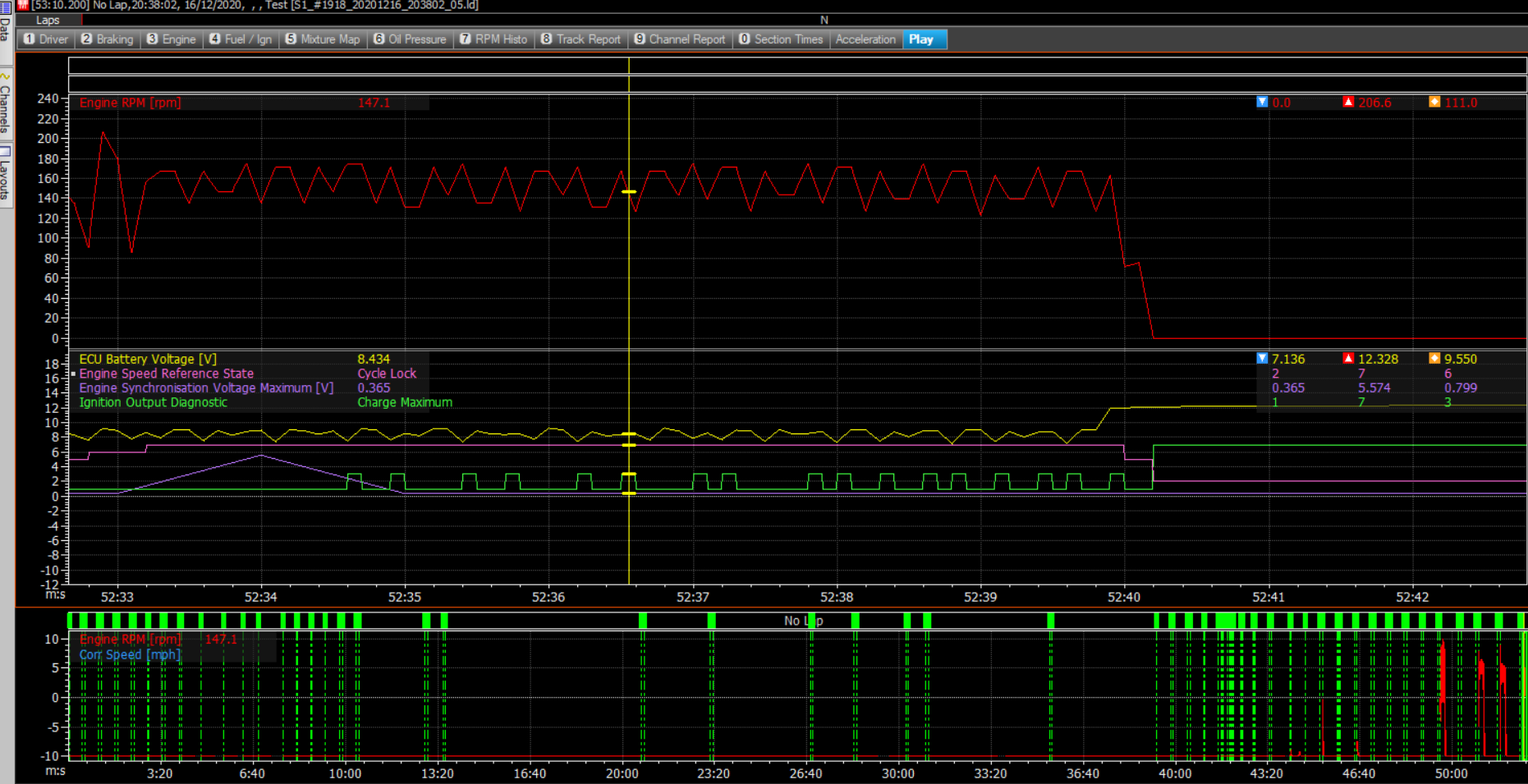

Hi all
How does my Engine position and reference wave forms look?
And, finally, after 15 years...
Screenshot 2020-12-12 143308.png (272.68 KiB) Viewed 12636 times

The Pullups should be on for Hall Effect sensors.

Also, the Hysteresis for ref and sync should be a fixed value for hall effect sensors. I would suggest 1V.

Postby greenamex2 on Mon Dec 14, 2020 8:51 pm
Thanks all, that is lunch times task.
Is the fact that the speed trace is "inverted" an issue?
I have ordered a sensor to match the reference one but just interested (especially if I need to use a wheel speed sensor in an emergency!).

Postby AlanB on Mon Dec 14, 2020 8:54 pm
Both ref and sync traces look fine.

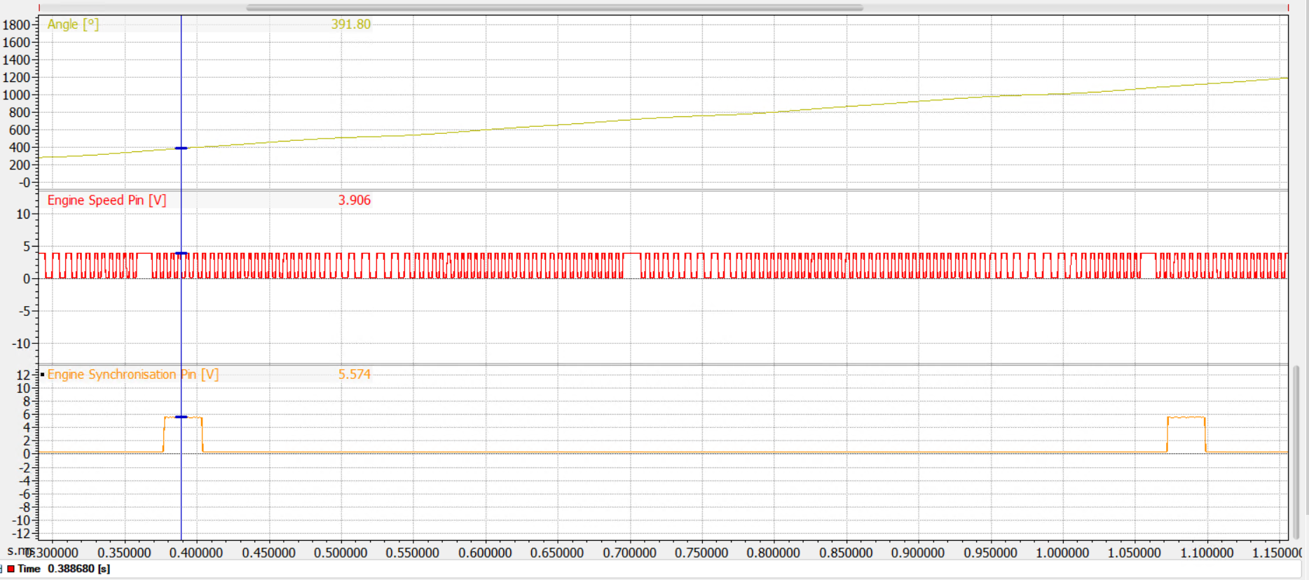

Postby greenamex2 on Thu Dec 17, 2020 8:32 am
OK, think I am nearly there.
Fitted a ZF GS1001 sensor to the crank and enabled the pull up and am now getting an RPM!!!
The only odd things are -
The peak voltage on the ZF GS1001 is only 3.9V...is this normal?
For info I tried to enable the pull on the Sync sensor and instead of having a 0-5.5V square wave I then had a 3-5.5V square wave. Weird. I disabled the pull up.
Just need to confirm where the missing teeth are in relation to TDC now!
i2 trace
Screenshot 2020-12-16 212741.png (247.95 KiB) Viewed 12517 times
Pin trace
Screenshot 2020-12-16 202807.png (337.01 KiB) Viewed 12517 times

Postby Stephen Dean on Fri Dec 18, 2020 11:55 am
It's fairly typical that a 5V+ fed Hall Effect sensor will output a 0~4V square wave signal.
