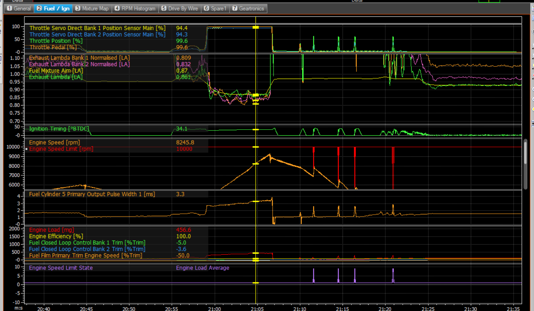

However, the engine is still cutting out about 9200 rpm for no apparent reason. You can see it in the screen snip below. Closer examination seems to be more like a ref/sync problem. Any guidance for how to narrow that down? Log/package can be provided if someone wants to look.

Hi John,
What is the Engine Load Average Engine Speed Limit set to?
Re: High rpm cut-out
PostPosted: Tue Dec 08, 2020 10:27 am
by parsonsj
Hi Stephen,
It's set to 10000 rpm across all cells:
