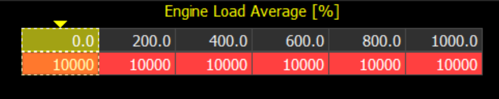

What is the Engine Load Average Engine Speed Limit set to?
Posts: 1852
Re: High rpm cut-out
Postby parsonsj on Tue Dec 08, 2020 10:27 am
Hi Stephen,
It's set to 10000 rpm across all cells:
parsonsj
