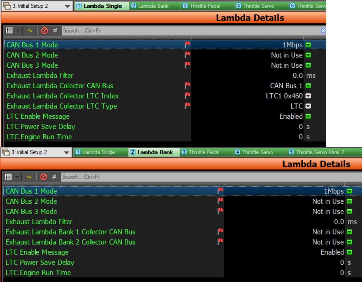

I have the same issue - just ignore it now, have tried to figure it out a few times. I checked my settings and I have
which is I think how Dave said to set them.
Re: Closed loop bank 2 sensor fault
PostPosted: Tue Sep 08, 2020 4:27 pm
by David Ferguson
That looks like what I would expect. It's possible there is a bug if the bank lambda were ever configured then turned off. You should tell us exactly what firmware / package you are using, and report that using the "Send Feedback..." menu
