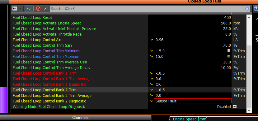

I am having a sensor fault on bank 2.
I dont run bank 2 as its a 4 pot so wondering how to remove this setting
sensor fauly.png (43.57 KiB) Viewed 8539 times

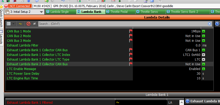

You should not configure bank lambda if you don't have two banks, just collector lambda.
So on Initial Setup 2->Lambda Bank worksheet, change Exhaust Lambda Bank 1 Collector CAN Bus to "Not In use".
Then switch to the Lambda Single worksheet, and make sure Exhaust Lambda Collector CAN Bus is set to CAN Bus 1, LTC Index to LTC1, LTC Type to LTC.
Let us know how it goes.

I have the same issue - just ignore it now, have tried to figure it out a few times. I checked my settings and I have
which is I think how Dave said to set them.

That looks like what I would expect. It's possible there is a bug if the bank lambda were ever configured then turned off. You should tell us exactly what firmware / package you are using, and report that using the "Send Feedback..." menu
Re: Closed loop bank 2 sensor fault
Postby Stephen Dean on Tue Sep 08, 2020 5:55 pm
This has been logged to be dealt with in the next release of the GP Packages.
