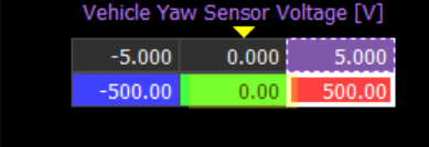

The Pitch, Roll and Yaw channels do not have a calibration selection, so you can’t select CAN 2DP.1.0 as suggested. You have to set up a table. I think I read somewhere that it should be 1 mV = 1 bit, so I think the calibration would be something like...
Code: Select all
V     -2.5   0   +2.5
*/s   -245   0   +245
cheers

You are correct about the 1 bit = 1mV part. The IMU sends 0.1deg/s per bit so you end up with the table below:
Yaw Sensor.png (14.12 KiB) Viewed 18133 times
