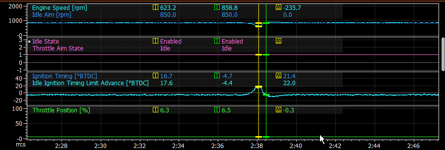

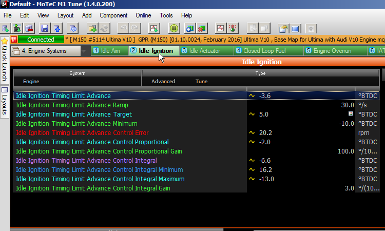

I have a M150GPR on a Audi V10. The engine runs and have done some tuning. I havea problem with the engine stalling when idling. Cannot find any reason for this happening other then the idle state changing from IDLE to NORMAL.Cannot not find anything that would make theidle state change. There is no fans or AC switching in or out that cuases this.
Another odd thing is the ignition timing is wrong in the live data compaired to what is in the tables and settings, It will got to amuch higher values then expected . I have included some screen shots and the package.
Ray.

Hi Ray,
The upper limit of the Ignition timing range is set by the Ignition Timing Main table. When the Idle Control system has advanced the ignition timing to a point that it has matched the ignition Timing Main table value, the Ignition Timing State will change from Idle to Normal to indicate which system is currently controlling the Idle Ignition timing.
I would advise that you remove the Overall trims in place for the Fueling and Ignition.
Can you post the logging from the engine stumbling under idle conditions?
