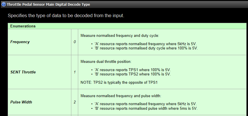

The Vishay TPS uses PWM at 1khz to encode its position location information, ranging between 10% and 90% DC. The M1 can best decode this by measuring Duty Cycle, not Pulse Width.
An example of setting this up would be as follows;
Sensor wired to UDig8
Throttle Pedal Sensor Main Resource - UDig8 Hybrid B
Throttle Pedal Sensor Main Digital Decode Resource - Universal Digital Input 8
Throttle Pedal Sensor Main Digital Decode Type - Frequency
As per the help for the Throttle Pedal Sensor Main Digital Decode Type, selecting the Frequency B Resource reports a Normalised Duty Cycle.
The M1 UDig input timing can resolve this duty cycle to a very high resolution regardless of the frequency.

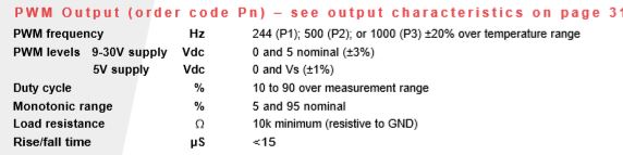

Postby greenamex2 on Fri Sep 14, 2018 7:36 am
From the product catalog -
Electrical characteristics

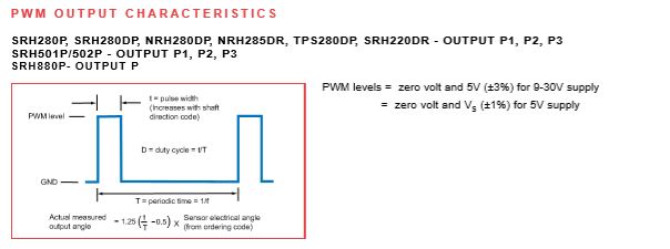

Postby greenamex2 on Fri Sep 14, 2018 7:37 am
And -
PWM graphs
greenamex2

Postby Stephen Dean on Fri Sep 14, 2018 9:24 am
Similar setup for that throttle as well, where you would measure the pulse width for the position data.

Postby David Ferguson on Fri Sep 14, 2018 10:31 am
I think you mean set the decode type to Frequency, and the Duty Cycle measurement (Hybrid B) will have the position data.

Postby greenamex2 on Sun Sep 16, 2018 5:27 am
That has doubled the resolution. That will do for now.
Thanks for the help.
