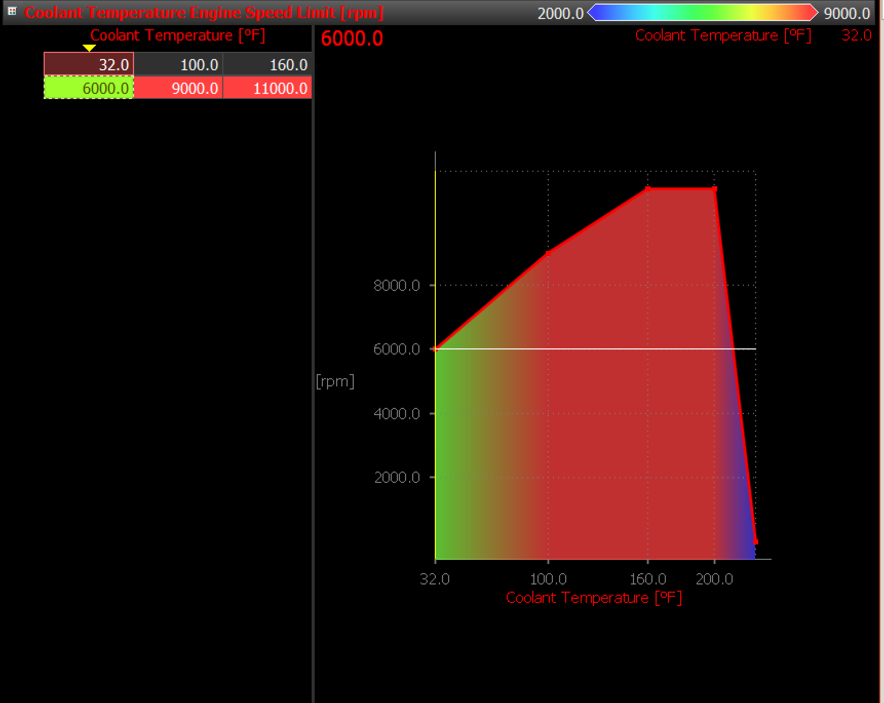

Postby Brody on Sat Feb 03, 2018 3:48 am
Perfect, hows this look?
Coolant Temp vs RPM.PNG (69.48 KiB) Viewed 9408 times
