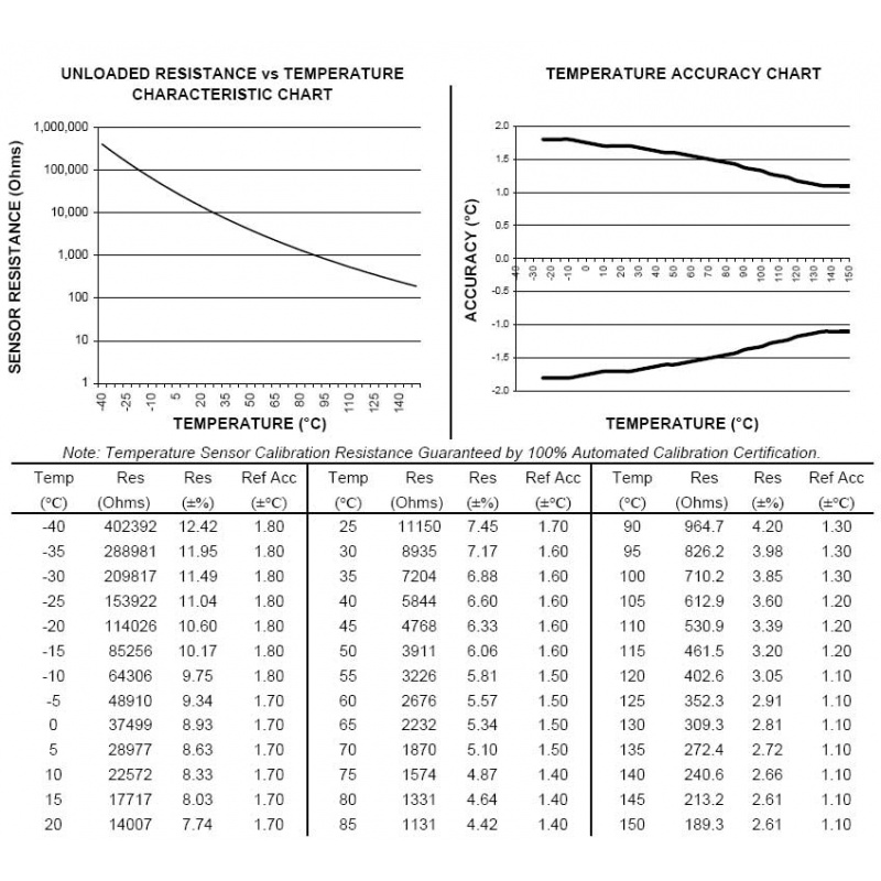

Install is progressing well , I need to Calibrate a sensor that's not on the drop down list,
Delphi/GM/Packard 12160855 that I want to use for Engine oil temperature, has a wide range and quick response compared to some.
I have a resistance Vs Temperature Data how do I extrapolate that to the Voltage trace?
Data attached
Thanks in advance

If you are wiring the sensor into an AT input then there is a 1kohm pull up to 5V.
So Vi = Vs x (R2/ (R1 + R2))
where Vi = The input voltage
Vs = Supply voltage (5V)
R1 = Pull up resistance (1kohm)
R2 = Sensor resistance
As an example at 0deg: Vi = 5 x (37499/ ( 37499 + 1000) = 4.87V
Just create a spreadsheet with all the values then copy them into tune.
