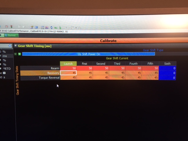

Ok, when changing from a ignition kill-shift type motorcycle transmission and going to a 1-2-3 AUTO TRANS (NOT AUTO SHIFT), where do you shut off the ignition kill on the 1-2-3 shifts?

I only want the ignition kill blocked in the first 3 gears and not 4th an 5th. No in all gears.

Sorry, I didn't realise that there was more than the three gears mentioned. In this case you can set the timings for the first three gears to 0 in the Gear Shift Timing table, and there will not be any cut applied.
MoTc Shift Kill.JPG (68.99 KiB) Viewed 13874 times
Here right?
0 all cells for 1st, 2nd and 3rd.

That is correct, setting those values to 0 will deactivate the function in those gears.
