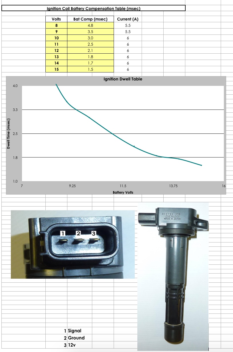

Postby tepid1 on Thu Aug 17, 2017 2:13 am
I have the info at home. I'll share as soon as I get in tonight.
tepid1
Posts: 50
Joined: Thu Jan 20, 2011 1:49 am
Re: Honda coil calibrations
Postby tepid1 on Sat Aug 19, 2017 10:44 am
For the 070 coil, but I find them all to work with this data so far.
