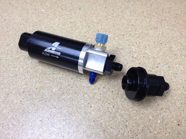

Where is a good spot for the fuel temp sensor? I have one in the fuel tank but would closer to but not in the rail be better?
Ryan
Posts: 4
Joined: Fri Jul 11, 2008 8:32 pm
Re: Fuel Pressure model
Postby David Ferguson on Tue Oct 18, 2016 3:02 am
You need to measure the fuel temperature and pressure of the fuel going through the fuel rail. I made up this manifold that replaced the end-cap on my fuel filter to provide ports for both temp and pressure.
Fuel Temp Manifold
FuelTempManifold - 1.jpg (56.13 KiB) Viewed 21863 times

If the default fuel temp is higher than the actual fuel temp, then the car will run richer than aim, and vice versa, so you are better off to have it set at a higher than ambient temp than lower.
Posts: 1857
Postby Scott@FP on Tue Oct 18, 2016 3:24 pm
Fuel temp in the return line somewhere usually works well. If its a returnless system it needs to be in the rail.
