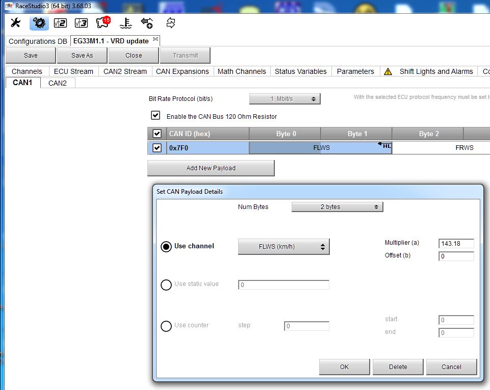

What the M1 is expecting is a frequency. Assuming the wheel circumference in your M1 Package is correct (1.940 meters both front and rear), then to convert from km/h to rev/s we would first multiply by 1000 (meters/km) to get meters, then divide by 3600 (sec/hour) and by the circumference to get revolutions. So
SpeedRevPerSec(Rev/sec) = SpeedKmPerHour (km/h) * 1000 / (3600 * 1.94) or just SpeedKm * 0.14318442. Now according to the help in M1 Tune for "Sensor Scale", it says the CAN values are expected to be in mHz (milliHertz), so to convert this we multiply by 1000. Giving us SpeedmHz = SpeedKmPerHour * 143.18.
So in your Aim RS2, CAN Output, you change the output channels to multiply by 143.18 as shown below
Aim Race Studio 3 CAN Output Configuration
RS3 CAN Output.JPG (90.33 KiB) Viewed 4475 times
In M1 Tune, I believe the Scale should now be 1.0, but you can change it as needed (have no data but there is data on the bus, then multiply by 10, 100 or 1000). Here is where I would start with M1 Tune on your package:

Dave has explained it all, however I have a different methodology for this, as multiplying the wheel speed value on transmit is more likely to get you into overflow for the two byte signed message.
In the ECU config do the following for each wheel speed:
- Set the scale to 1431.8
- Set the sensor teeth to 100
- Set the sample teeth to 1
This will allow you to leave the dash as transmitting wheel speeds.

Thanks for your help David and Nathan.
I first tried David's config and this resulted in some wheel speeds but something's not right, the first wheel FL is doing something different to the rest in that it flashes to 256 and then a more or less correct number, with many Communications Timeouts happening what seems like every 1 sec, other 3 wheels cycle between correct number and near zero when the timeout happens.
I tried Nathans suggestion, but could not use "1" tooth, that's invalid, so used 0 and that resulted in the same behaviour as above, but wheel speeds were x 10 off(2.8 for 28).
