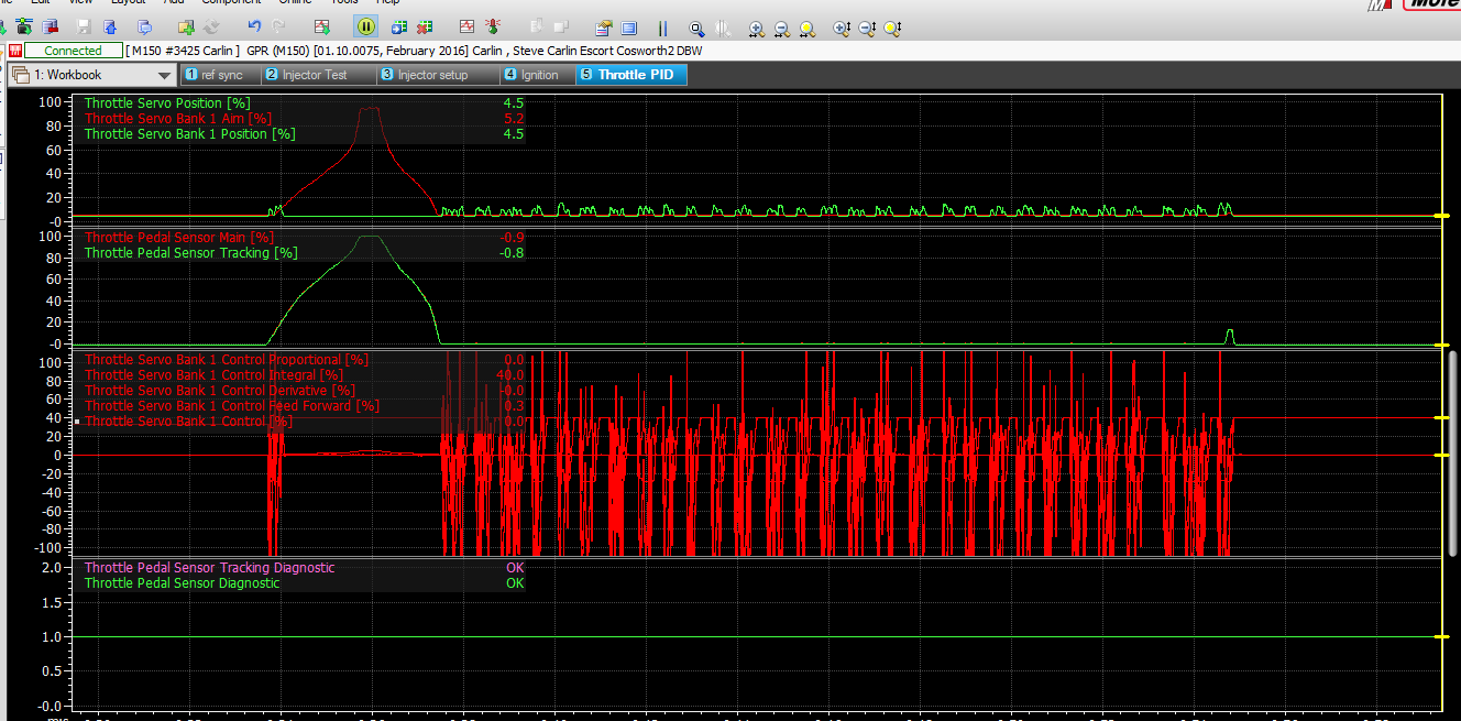

emailed the package
Looks bad on the same settings
dbw back to normal.png (91.58 KiB) Viewed 4313 times

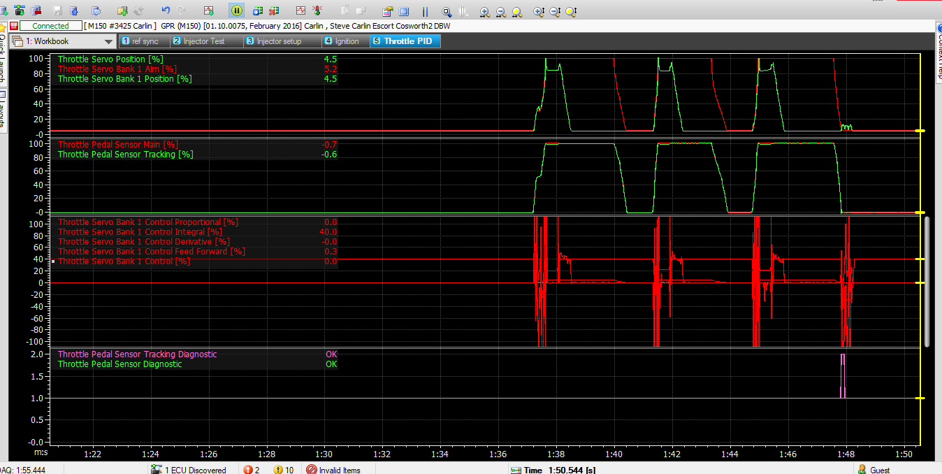

this is me stamping on the throttle
dbw back to normal2.png (88.75 KiB) Viewed 4312 times

Changed the throttle body and got this working. It does appear that the one i was testing was faulty but no 100% it wasnt the calibration. Either way i am ordering a new body today.
