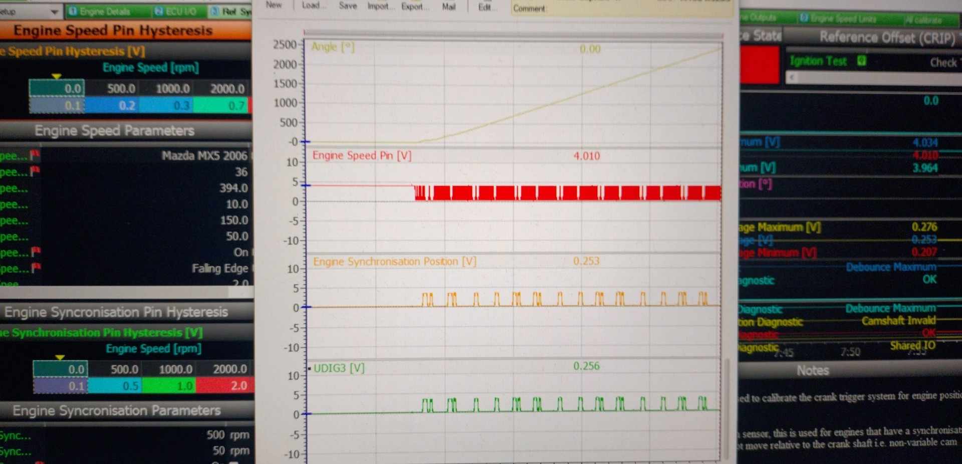

I've got an M130 on a Suzuki M series engine with VVT. Wiring appears to be working as a trace of a cranking process appears to show the tooth patterns expected (Mazda Mx5 2006, which is what the engine speed reference mode is set too) While cranking I get pattern lock but never achieve cycle lock and as such neither the injectors or spark fire (an ignition test proves the wiring will trigger a spark on the correct cylinder as does an injector test.) the Engine speed reference Offset has been confirmed by two other sources, 1 running a similar engine (different ecu brand) and the Shhh... Haltech site (sorry)

Id also post snips of the M1 tune pages and the trace if I could work out how to on this forum. Advice also sought if it helps.

Screen captures do not help, you will need to provide the information requested to allow for us to assist you. Otherwise, the MoTeC Dealer that sold the hardware to you should also be providing assistance in getting your engine running.

thanks for the help, screen capture was a mate not me, thanks Simon!
Here is What I think are what you need. input capture export (archive) and the Package export (Archive)

Where is the Camshaft Position sensor wired into? Universal Digital 2 or Universal Digital Input 4? If I disable the Engine Synchronisation Resource (UDig 2) in your Package, and run the Cam Position signal into UDig 4, I get Cycle Lock. Can you disable the Engine Sync Resource by going into Tools \ Edit Input/Output Resources... and setting the Engine Syn Resource to Not in Use. This will require the M1 to be restarted to effect the change. If this still doesn't get Cycle Lock, can you do another Input Capture, ensuring that UDig 4 is also captured.

Camshaft position was wired and assigned to UDig 2. Udig 4 piggybacks this signal and is assigned (hopefully) to VVT position sensing.
I have attached the capture with Udig 2 disabled and UDig 4 on (inlet Camshaft Bank 1 position [V]

I have assigned Udig 2 to the Inlet Cam Bank 1 Resource in this Package, the signal should not be split so remove the wire into Udig 4. This Reference Mode does not need a Sync input allocated as it uses the Inlet Cam Position for Synchronisation.
