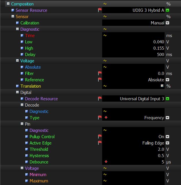

Useful information would be what sensor you are using for the Ethanol content, and how you have it wired.
What is your Fuel Compostion Sensor Resource and Fuel Composition Sensor Digital Resource selection?
What is your Fuel Composition Sensor Calibration selection (or Fuel Composition Sensor Translation)?

The Fuel Composition Sensor Resource is UDIG 3 Hybrid A.
And Fuel Composition Sensor Digital Decode Resource is Universal Digital Input 3.
Fuel Composition Sensor Calibration is Manual.
Fuel Composition Sensor Translation is 0.050v 0.0% to 0.144v 100%(Setup according to MoTeC M1 Flex Fuel User Guide)

The Fuel Composition Sensor Digital Decode type needs to be "Pulse Width" for that sensor, although that should only effect fuel temperature, not the composition, but give it a try.
Perhaps you have a faulty sensor, or the frequency of that sensor doesn't vary from 50 - 150 hz depending upon the ethanol content. BTW, that sensor has a diagnostic to indicated contaminated fuel, perhaps that's what's happening. Here is a note from one vendor's website:
The normal range of operating frequency is between 50-150Hz. The microprocessor inside the sensor is capable of a certain amount of self-diagnosis. An output frequency between 180Hz and 190Hz indicates that the fuel is contaminated.
Perhaps you could use Online->Capture inputs to see what the frequency of the sensor is at the various Ethanol content.

I did change the Fuel Composition Sensor Digital Decode Type to "Pulse Width". No different.
And the frequency is around 190Hz. I think the fuel was contaminated.

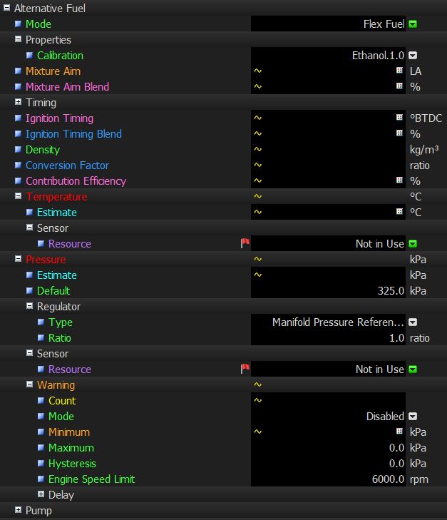

What have you specified for the Alternate Fuel Properties Calibration. A common mistake is select the E85, but since you have the sensor, you should be selecting "Ethanol.1.0" as the alternate fuel. The sensor will read 85% if E85 is supplied. That would explain how nearly E100 reads as nearly E85.
The alternate fuel is selected under Initial Setup->Engine Details.
Re: Flex fuel setup
Postby junnan yue on Mon Apr 20, 2020 4:43 am
My Alternate Fuel Properties Calibration is "Ethanol.1.0".
So there must something else?
