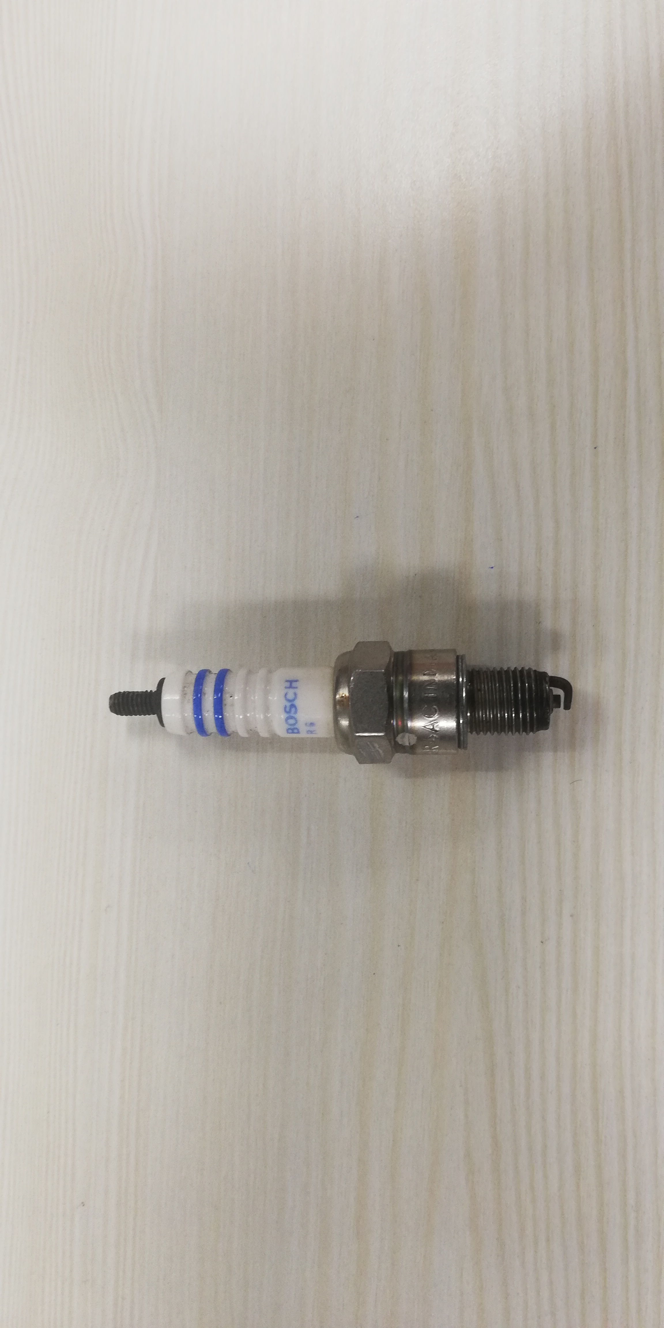

Ok, so I think I should change the injector and the ignition coil. I browsed through the available list of pre-calibrated ignition coils and concluded that the Mitsubishi F6T577 is suitable for my spark plug. But in the help, it is mentioned that it requires IGN4 Module, which is the case with all the two-pin ignition coils in the list.
Do all the coils require an external driver, or can I use 3 or 4 wire coils (such as Hanshin A/C-4002E or Denso ones) without external drivers? Can you suggest 2 or 3 coils that can be used without any hardware addition and can be appropriately fitted on the spark plug? I have attached the image of the spark plug for your reference.

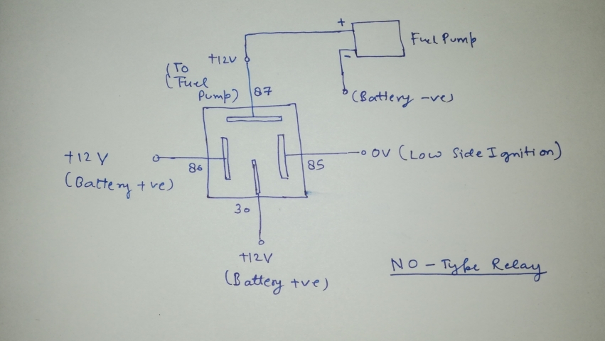

The Fuel Pump needs to be powered through a relay, preferably a Solid State Relay. The ECU Pins are not designed to accept the current draw of running a fuel pump. Grounding the fuel pump directly through a Low Side pin will result in damage to the M1.

Postby srivsaga on Wed Feb 12, 2020 8:44 pm
Thanks for the info. I have attached the wiring for the fuel pump. I think I have got it right now.
With reference to the Ignition Coil, I can just select the coil calibration as VW 06E 905 115 E, and it will include the calibration files, right? Also, I did not get the difference between pin 2 and 4. I have just an engine installed on the test bench, so I guess both will be the same, to the engine block. Please correct me if I'm wrong.
