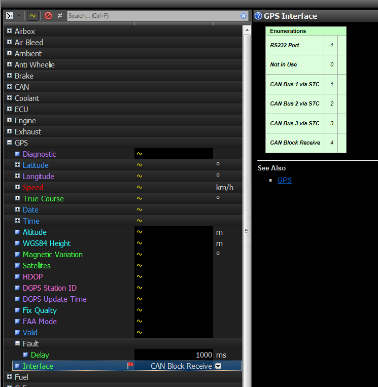

attached is the package I'm using. Where do I have to Setup the GPS Diagnostic Value? In the M1 Tune?

Fault Delay was set to 1000ms

Could it be that the Interface must be set to CAN Bus 1, instead of CAN Block Receive?
I'm using a STC, so for me it would make sense. I know see that the diagnostic value only can be seen when the ECU is connected so I have to wait after work to go to my workshop to see what is the value.

If you are using an STC then you need to set the GPS Interface to 'CAN Bus 1 via STC' before the ECU will receive GPS data.
The package you are using does not support GPS lap timing as this is a fairly new feature, so you will need to use your ADL3 for the lap timing. This is quite straightforward, as the ADL3 can also receive the GPS data from the STC.
Contact MoTeC Europe support if you need help with the setup.
