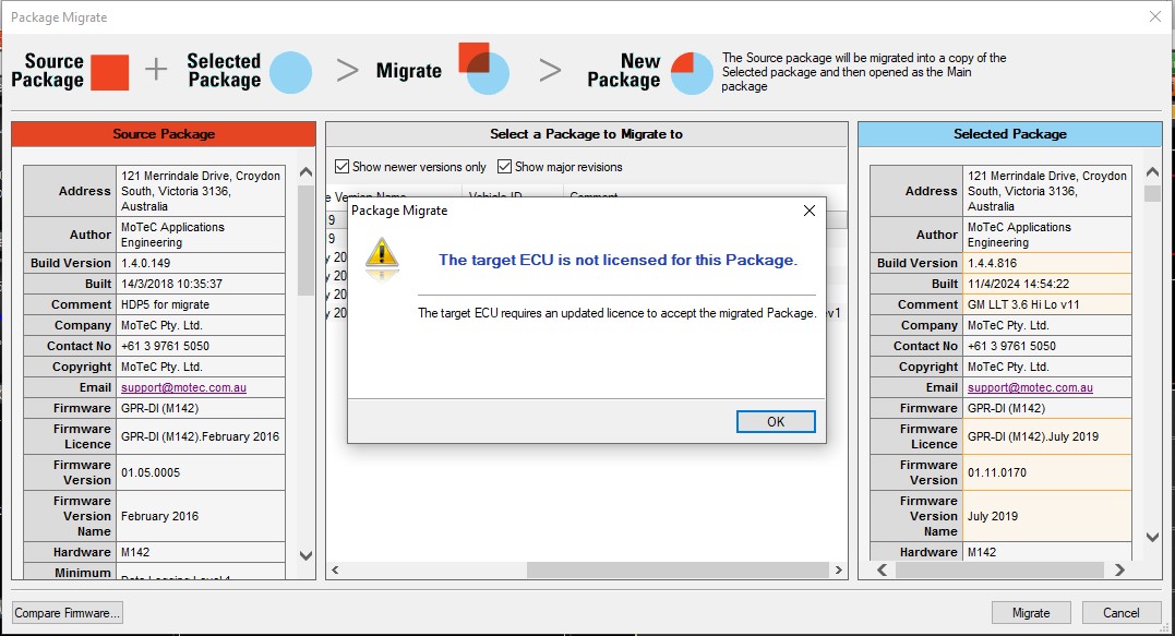

Postby dr350 on Mon May 19, 2025 8:53 am
Hi Stephen,
Thank you very much for your response.
I'm working on migrating the firmware, but in the latest versions, there's a warning that the license must be updated. Is this correct? Is there an additional cost?
Thanks,regards!

Postby Stephen Dean on Mon May 19, 2025 2:39 pm
Send the serial number through to support @ motec.com.au and I'll sort it out for you.
