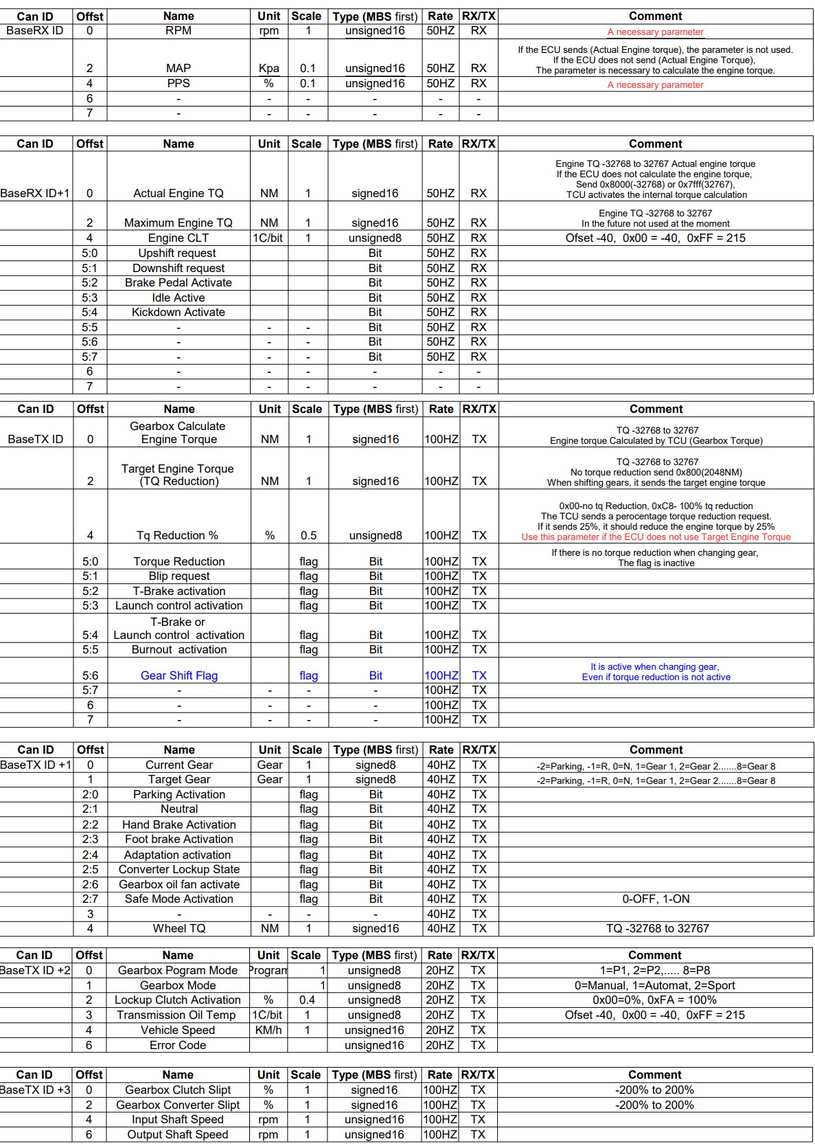

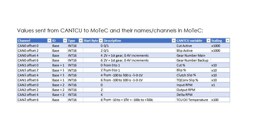

Stephen
Blip is sent as a CAN message(see attachment), or it can be sent via aux out blip active or 0-5v blip %.
Is there a way to integrate this ?
Might also be able to get CANTCU or Turbolamik makers to add a custom message, what is it that the GPRP package needs to see to have this functionality ?
thanks
cantcu m1coms.JPG (66.63 KiB) Viewed 445 times
New type 7 CAN mess.jpg (604.5 KiB) Viewed 445 times
