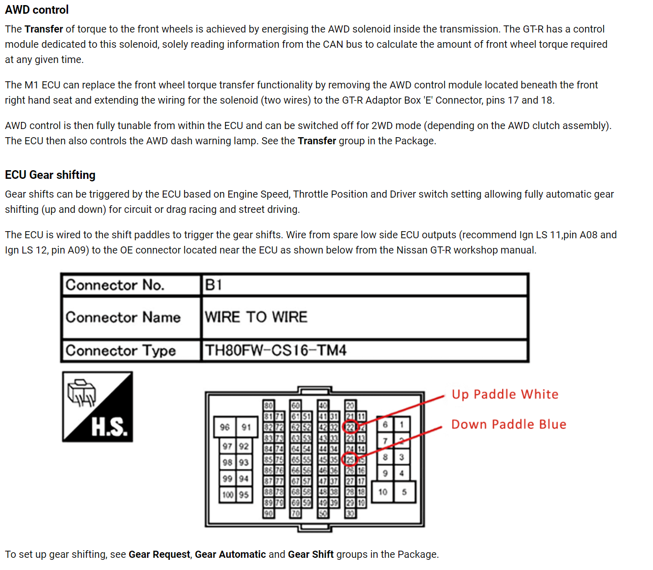

To control the AWD, it requires the factory controller to be unplugged and wiring run for the solenoid to the breakout connector on E17-E18. This also requires one of the narrowband lambda sensors to be used with the current sensor circuit in the adapter box.
R35 Transfer Control.png (324.07 KiB) Viewed 3443 times

"To control the AWD, it requires the factory controller to be unplugged and wiring run for the solenoid to the breakout connector on E17-E18. This also requires one of the narrowband lambda sensors to be used with the current sensor circuit in the adapter box."
Would this be the following narrowband lambda?
A11 - LA_NB1 - Lambda Narrow Input 1 - Internal - Front Drive Clutch current sense
