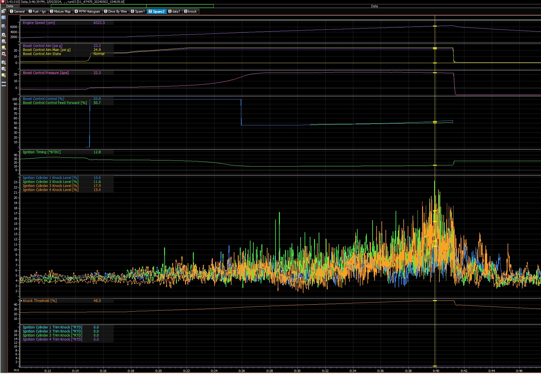

I had my car on a mates dyno yesterday, I have owned the car since February and I just wanted to check ignition timing, fuel and boost
All looked ok in his opinion, but it was down about 1.5psi in boost from the original dyno sheets I was given, as I had added a front mounnt intercooler, and also a process west intake manifold
Vehicle in question is a 2016 Subaru STI, built motor, FP Green turbo, and all other suporting mods to make 300+kw at the wheels on e85
We ended up at 270kw on BP98, turbo was pushing around 23psi, and the ignition timing was hovering around 11.1deg.
He had a couple questions for me to ask here and they are below
*****Boost Control Topic*****
- Aim difference

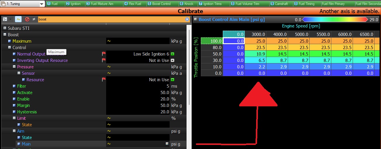

When ramping up the vehicle we noticed a difference of around 1.7psi at all times, we were using the boost control aim main table to increase the desired boost pressure, however there was always a differance of almost 2psi between actual boost conrol pressure and boost aim, see attached image, we were demaning 25psi but getting around 23.2

Noticed a very large difference between knock level and threshold, I was advised to lower threshold percentage lower in order to catch knock if occures

Boost Aim can be limited by a number of other subsystems.
The limit is applied as a percentage of the current Boost Aim Main.
Boost Limit will indicate the current percentage limit, for example 100% means no limit is applied where as 50% would indicate the actual Boost Aim value will be 50% of the Boost Aim Main (other subsystems such as launch and anti lag can also override the value from Boost Aim Main but lets ignore this for now)
Boost Aim State will indicate the origin of the value of Boost Aim.
If Boost Aim State is Limited then Boost Limit State will indicate which subystem is currently imposing a limit.
Boost Maximum would be the boost cut value, if Boost Pressure exceeds Boost Maximum then boost control is disabled and the fuel outputs are disabled.
The Knock Threshold must be exceeded by the Ignition Cylinder N Knock Level in order for the Knock subsystem to retard the ignition timing, Knock Trim Gain controls how much of a reduction in ignition advance is applied.
