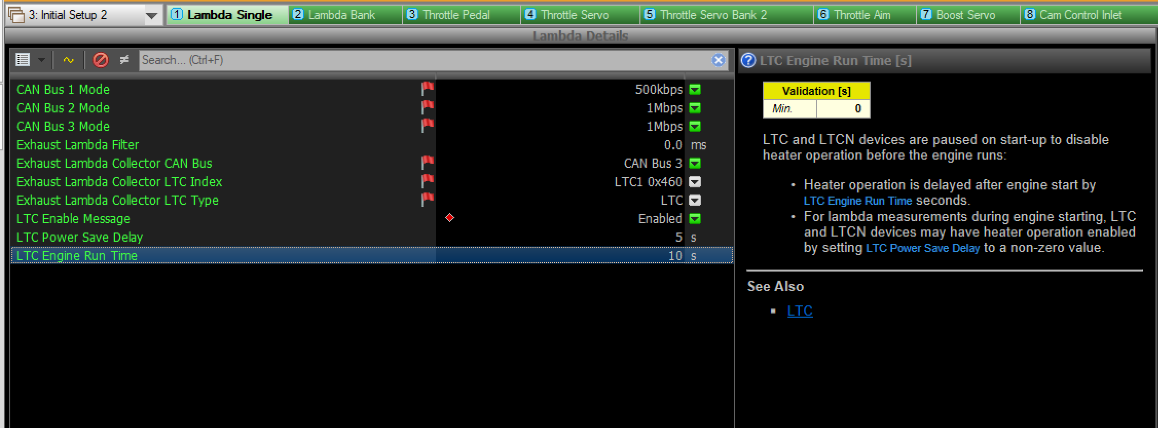

PS: Is there a way to make the LTC start after the engine has warmed up? Like in the M800 normal heater function?.

Hi Vlad,
In regards to the LTC, the enable message delays the LTC heating up the sensor. IOf you have the enable message on, you can set the LTC Run Time (in seconds) which defines how long after the engine state is "RUN" before the sensor is heated.
As for your Anti Lag questions, there are a lot of systems at play, and it will be hard to advise without some logging or the config.
LTC Delay.PNG (84.25 KiB) Viewed 4943 times
