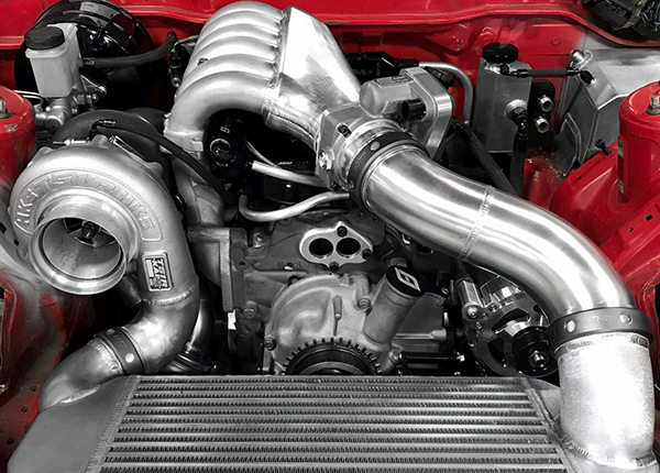

Hi guys,
I'm building a bridgeport 20B RX-7 and I'm currently shopping for an ECU.
Some people suggested me to go with a Link Thunder. However, I wouldn't mind
spending more money and get a motec ECU, since I'm already going for a PDM setup aswell.
Now, to be honest... I have no experience when it comes to ECUs and tuning related stuff, hence why I'm here asking for a precise answer.
My main question is, which one of the two ECUs (M130 vs M150) is the better product for me? What is the difference between the two?
The setup:
- 6 plugs (2 per rotor) all powered by individual GTR coils
- 9 injectors (3x1000cc primaries / 6x1000cc secondaries).
- Aim dash
- 1 PDM
- A/C
- e-power steering
- e-water pump
- 2 (maybe 3) wideband sensors
Oviously, I'd rather get the M130 if I can get away with it, since it's cheaper than the M150.
If someone knowledgeable could chime in , that'd be great!
