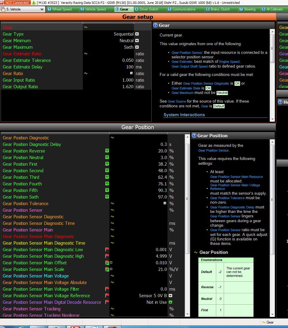

Have you calibrated the sensor? Sounds like Gear Position Sensor Main Diagnostic Low and/or High is not set correctly. What does the Gear Sensor Main Voltage show as you change gears?
Assuming it is changing, then you need to first set the Gear Position Sensor Main Offset and Scale -- I suggest you manually enter the values I I have used below (Main Offset 0.01V and Scale 21%/V). Then with Gear Minimum and Gear Maximum set correctly, put the bike into each gear and press the appropriate Q button for the Gear Postion to set the percentage of the Gear Position Sensor Main for that gear.
Here is my configuration for a GSXR 1000, notice the parameters shown in the lower pane.
Suzuki Gear Calibration.JPG (212.85 KiB) Viewed 8715 times

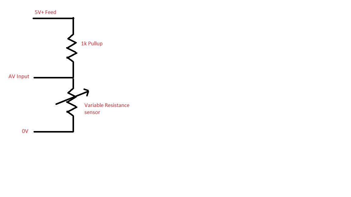

The Hayabusa Gear Position sensor is a variable resistance sensor, if you connect the output wire (Pink) to a AT and the Black/White to a 0V, then you will get a variable voltage signal that can be mapped for gear position. The third wire (Blue) is the Neutral signal wire.
You can also splice a 5V+ into the AV that you are using through a 1k ohm pullup resistor (making the AV into an AT) and this will also work.
AV into At wiring.png (8.64 KiB) Viewed 8714 times

David mine does not show % it shows mv and there is numbers in there.
SDean dumb it down a little for me please.
I have 3 wires on the motec
1 that has 5v on it
1 that is signal on b21
1 ground
What wire hooks where
