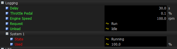

Is there logging to be retrieved? Can you have a look at the Logging status channels as below.
If the Used value is 0%, then you will get the same error as you are showing.

Postby bing on Tue Aug 09, 2016 1:55 pm
I have 84% used..
