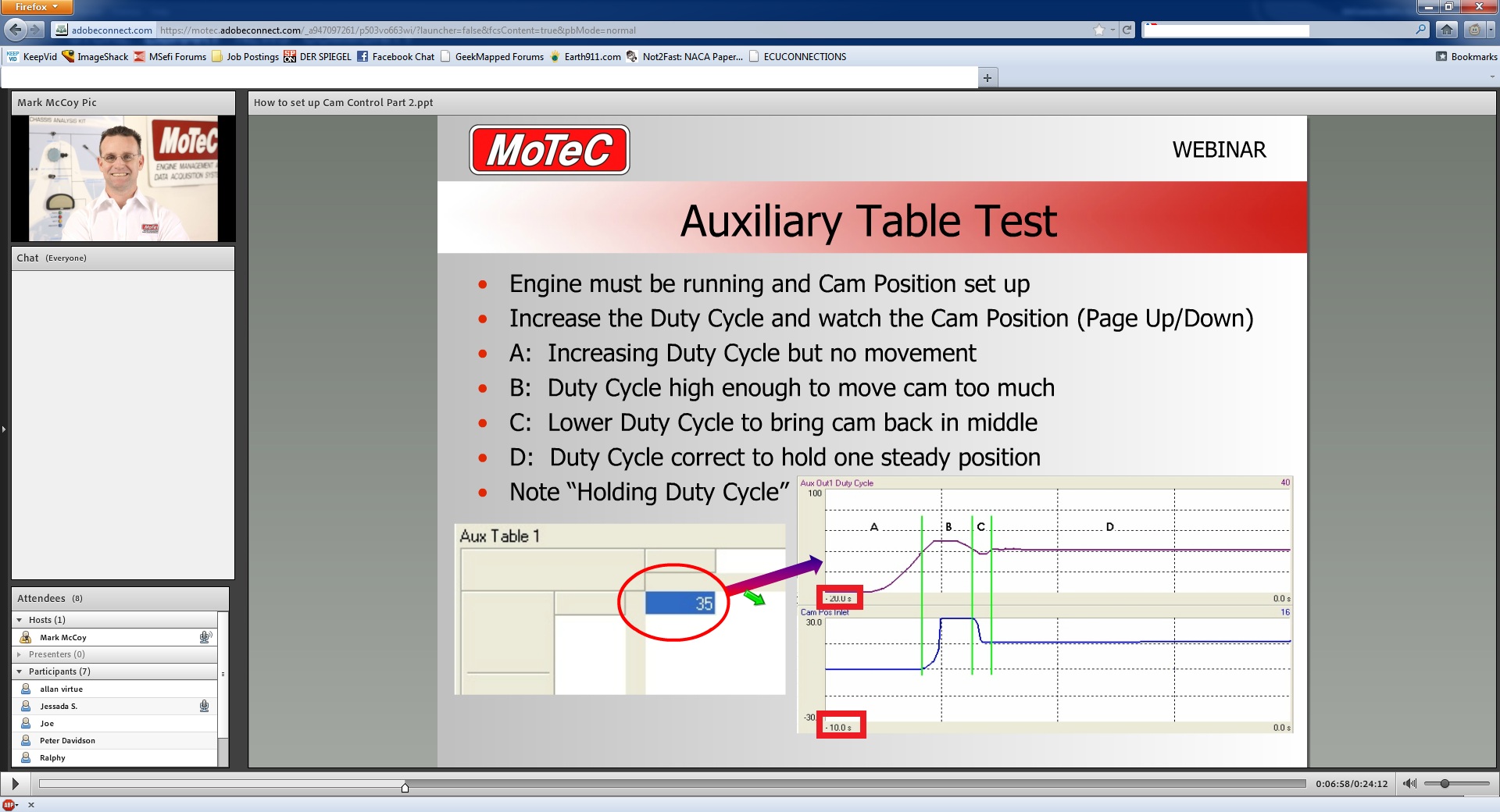

I was watching part 2 of the cam control setup and noticed that there is an issue with the chart axes on one of the recorder plots that is shown. Why does one axis go from -20 seconds to 0 seconds while the other axis goes from -10 seconds to 0 seconds?
