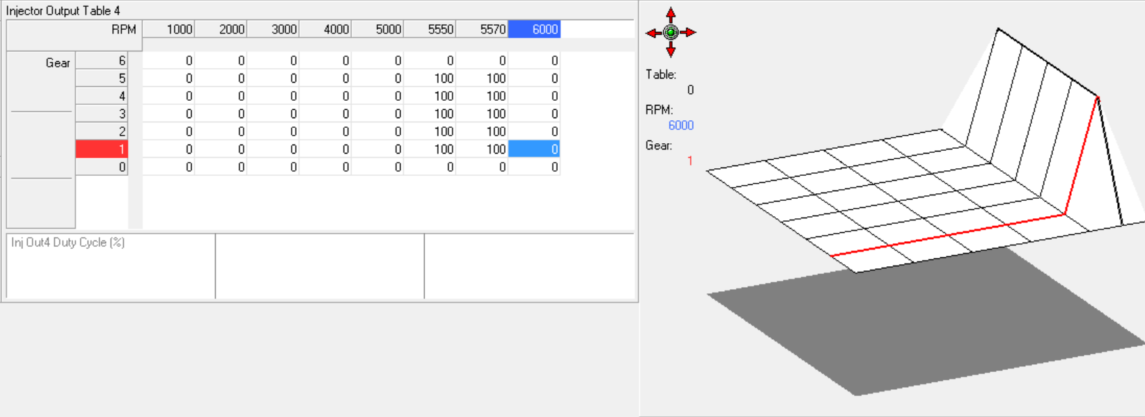

Postby mich9 on Sat Jun 24, 2017 3:32 am
We tryed direct Digital Input (Gear Shift Up) - Aux Output ( Gear Shift Light) wiring and it works very well! We'll test also in parallel with paddle shifter.
However with a generic Aux Table (Switched) it doesn't work fine. Our Aux Table is like this:
Hysteresys Off
