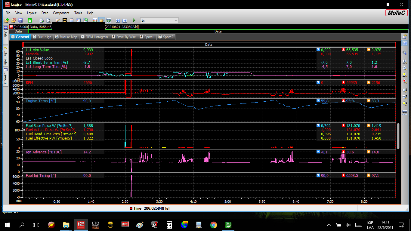

Hi
We are working on a vehicle that has a motec m84 installed, and when looking at the data we see strange maximum values ​​in several channels, for example: TPS: 6554, rpm 65535, error group, lambda, etc. This occurs when the motor stops, or the current is cut off.
Any problem in the wiring or installation?
Setup?
Thanks, Regards!

Sorry for not being more specific.
It is in the logger data m84 file.
I attached screenshot on i2.
Thanks,Regards!

If I had that log file, I would zoom in to the peaks and try to understand why they occur.
I would tend to ignore them (I would zoom in and scroll the data to running data only, then the min/max would be valid value).
To prevent them from going in the logging file at all...
What are your logging conditions (Adjust->Data Logging Setup->Start/Stop Parameters. I tend to start when the engine is either cranking or running (RPM > 250 for 0.1 sec), that can eliminate incorrect data samples.

Postby dr350 on Wed Jun 23, 2021 6:42 am
Ok, I see if I can find something the moment where the peaks are.
Yes, we have been working that way, leaving the peaks on one side or the other.
I had done tests with the data logging setup start / stop but it continues.
(ex: start: RPM> 200,300,500-- stop<500,300,100, 2 a 5s.)
Thanks, Regards!

Postby Stephen Dean on Wed Jun 23, 2021 9:46 am
This occurs when the ECU hardware resets whilst the logging is running, the maximum value for the channels is reported and logged during the reset process, this will also occur if the ECU is power cycled whilst the logging is running.
