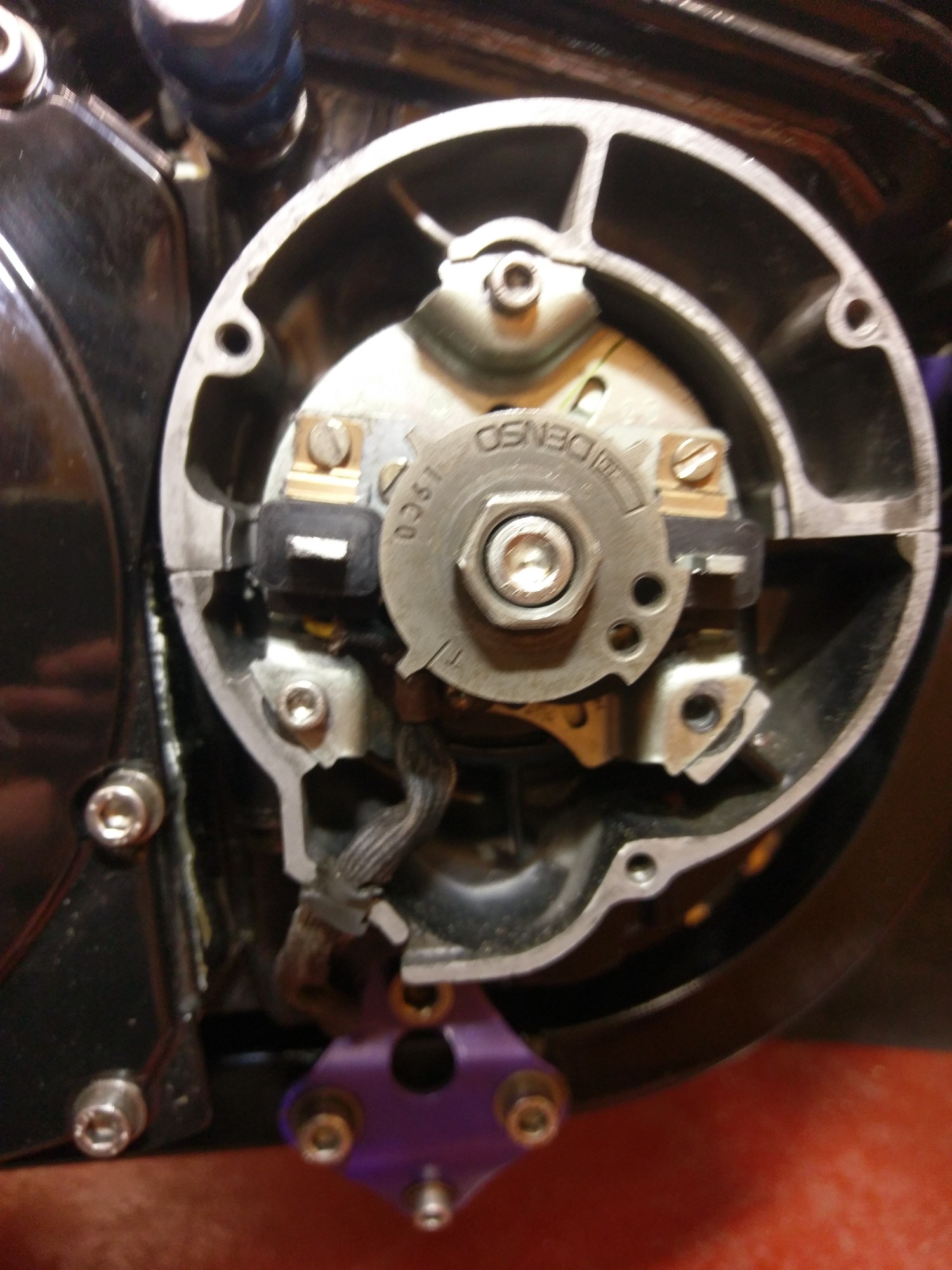

I have the following information from the existing ecu manufacturer
"At speeds below 700 RPM the ignition timing is fixed to spark on the rising edge of the tooth that precedes the long tooth(slug) (cyls 1/4) and the tooth that follows the slug (cyls 2/3).
From 700 RPM upwards the ignition timing is adjustable."
I could possible fit a cam sensor, but it will be tricky.
Also the pickup to the left of the first picture is the only one being used, the one to the right is disconnected.

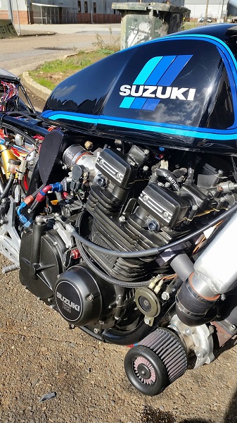

Re: Suzuki GSX 1100 Best trigger wheel to use
PostPosted: Sat May 09, 2020 7:02 pm
by Sean
Sync sensor on a GSX1100, GT101 reading off a cam lobe. You could use a GSXR sync sensor, but need to check. Some of the GSXR ones have a weird offset signal. What cams do you have in it, generally the aftermarket like Web Cam have fairly pointy lobes.
I'd run a later GSXR trigger and pickup. They're standard EFE pickups on there now?
This bike isn't mine, but I've done a bit of work on it.

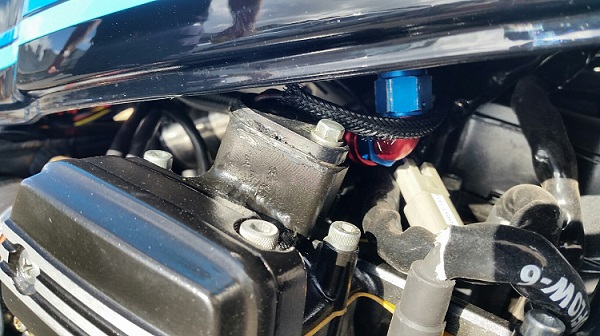

PostPosted: Thu May 14, 2020 1:47 pm
by harky
i fitted a cam sensor on a B1 Gpz1100 Kawasaki , first one was on a cam lobe ( with std cams — very pointy lobe ) worked fine , i used 10,000 Rpm , when i fitted different high profile , long duration cams , the ecu would “ loose “ sync over 5000 rpm , i fitted a sensor on the exhaust cam sprocket , a simple tab the sensor saw , ment some welding and fabrication of the cam cover
photo is upside down , but illustrates where the sensor was fitted
