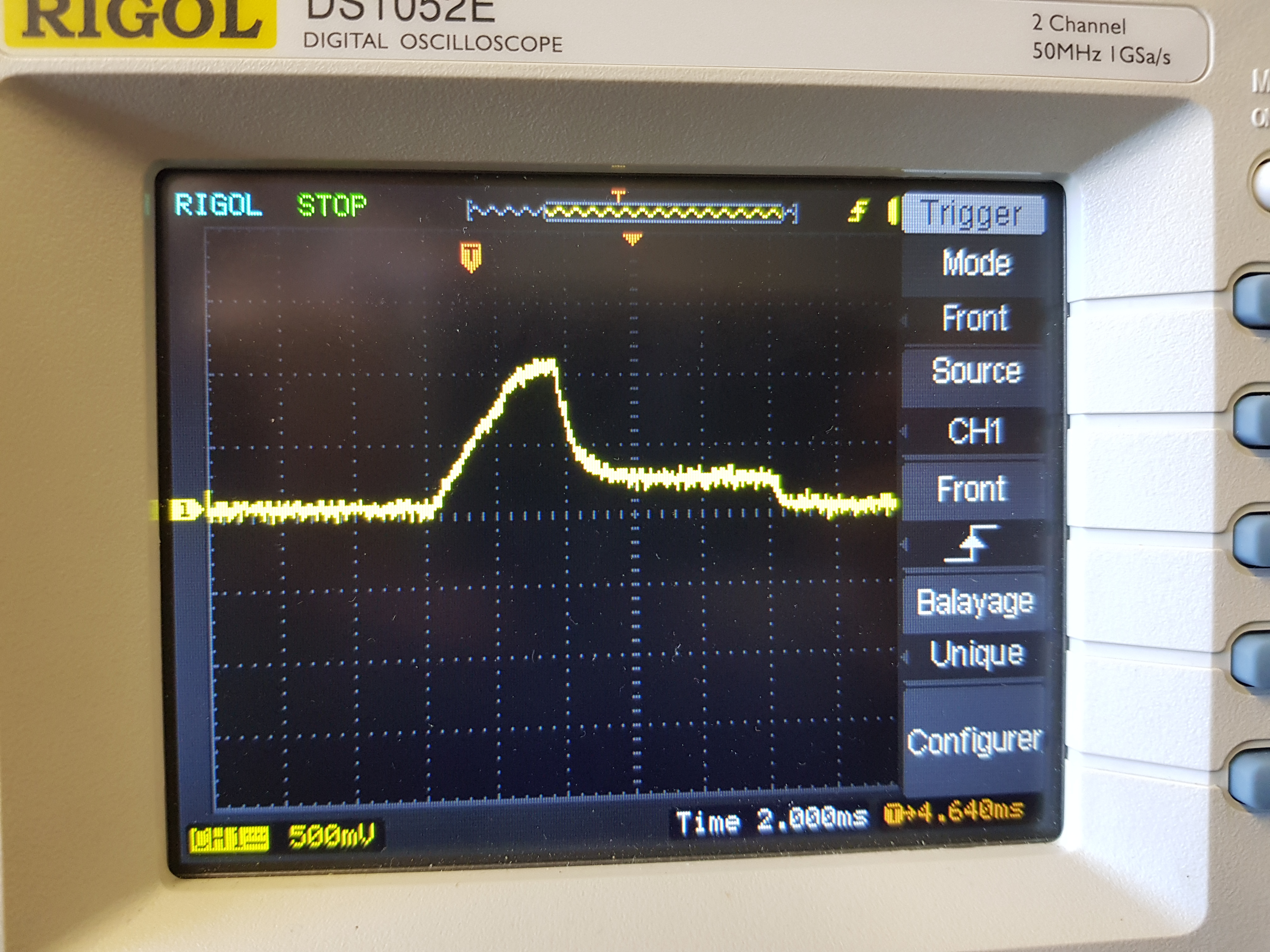

I'm using a Honda 50cc injector (16450-gev-762) with a M84 ECU
I did probe the injector current with a current clamp and oscilloscope.
The result is the following, with injector current = 1A in Motec config and 1A=1V for current clamp
Mesure courant injecteur honda 50cc 16450-gev-762.jpg (4.12 MiB) Viewed 8171 times
I dont see the notch that gives the injector current as described here :
viewtopic.php?f=11&t=187&p=2108#p2108
Does this injector has already been caractrized ? Which current value do i have to set in Motec config ?
I use 0 Amp for the moment but i have strange behavior sometimes.

We have not characterised these injectors.
What is the resistance across the pins of the injector?

it's 13Ohms
