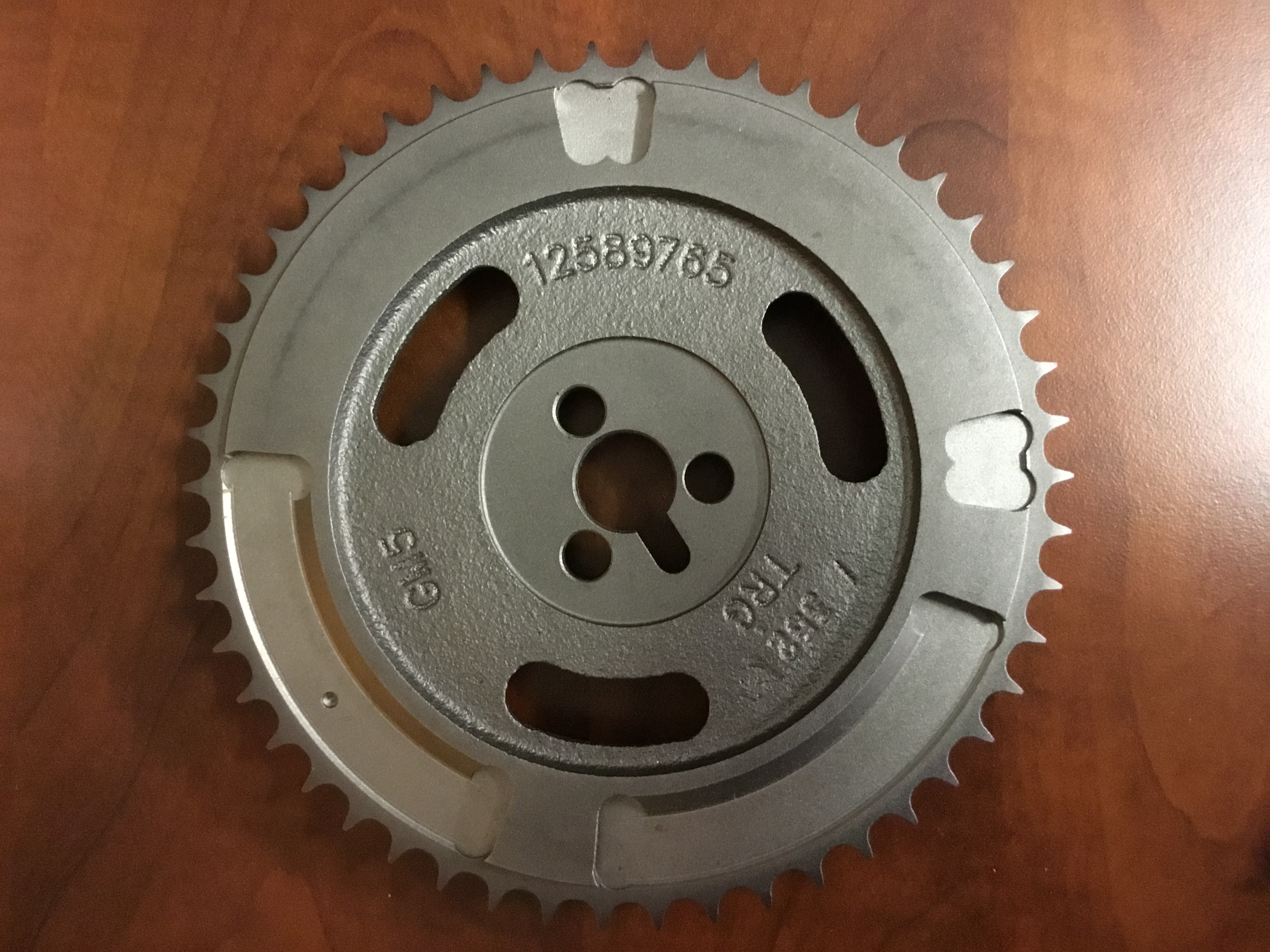

Hi
How do I go about configuring the sync sensor for the BBC 4x position cam sensor ?
This is the EFI Connections kit with 4x cam and 58x crank reluctor.
See attached picture.
Cheers
Clayton

My understanding, from having a quick browse through the EFI Connections web site, is that this kit emulates the late 58x LS cam and crank signal, so therefore I'd guess mode 17, same as a 58x LS. I have no first hand experience of this setup, so I'd recommend confirming with MoTeC directly.

I did call Motec and they recommended mode 17 as well.
