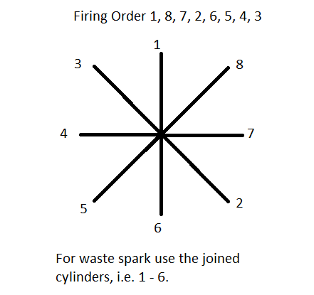

in waste spark every coil is connected to two cylinder, my qustion In which cylnider each coil are connected ?
Re: 8 Ignition output in M84
PostPosted: Mon Nov 27, 2017 8:50 am
by Stephen Dean
You need to connect the cylinders that fire 360 degrees apart for waste spark, the easiest way to work out which cylinders these are is to do a star diagram like this, and use the joined cylinders in waste spark.
Waste Spark.png (7.15 KiB) Viewed 9915 times
