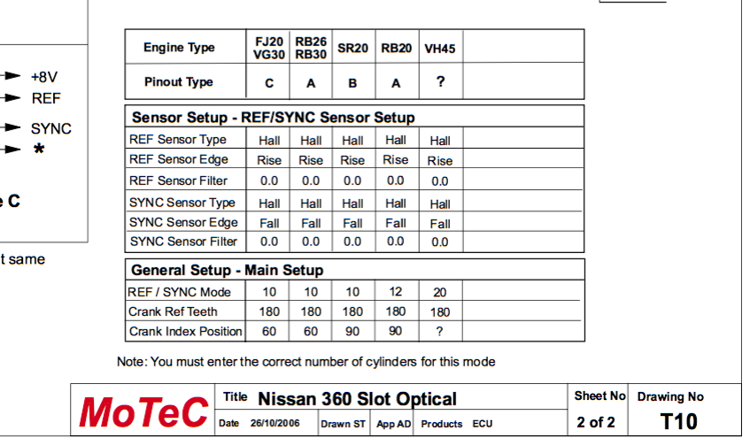

I also bought a M84 for my test car, to mess around with it a bit, get more used to it. My first question, and the only one i hope, is the ignition system. Dose the M84 have built in high power transistors? like the m800? Or do i need a ignition amplifier?
Solved it with the vtc solenoid, on-off using aux output load vs rpm
Also, i think i'm going to need a bit of help when i'm going to wire the oil pressure sensor, to make some sort of rev limiter if i have low oil pressure, a safety measure. But i'll ask when i get there.
PS: will the trigger settings for the SR20 from the drawing work fine ?
Regards,Vlad.

Hi Vlad,
The M800 doesn't have internal ignition amplifiers, if you run coils that need an external amp without one, you will damage the M800.
If you have the standard trigger system still on the engine, then the settings shown will work.
