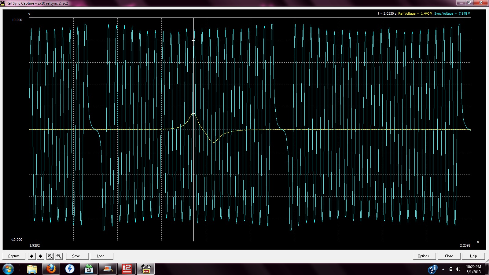

Has anyone run a m84 on the zx10 yet? This is my first motec and I'm having some difficulty getting it to sync. I'll provide what ever info that is needed. Thanks in advance.

Can you send a couple of ref/sync captures, one with all the plugs in and one with cyl 1 plug removed?

I Think i have my ref and sync sensors wired wrong. The Ref wiring is going to the Sync sensor and the Sync wiring is going to the Ref sensor. I am not sure how i missed this or the other people i sent the Capture to. Take and look and see what you think. Also i have not seen many Captures but it looks like my sensor voltage is really high during cranking on my ref sensor(sync sensor on this graph)
