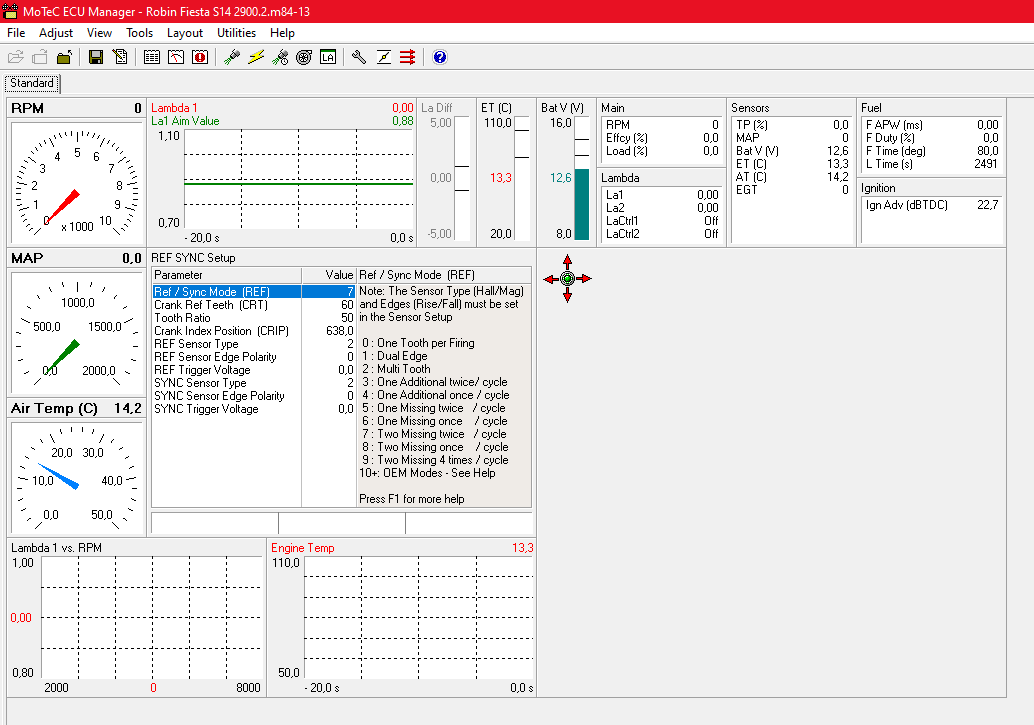

When trying to transfer base map settings from the M48 to the M84, I can't seem to get my head around trigger setup.
The motor has a 60-2 on the crank, and a 2 "tooth" pattern trigger on the cam (from bmw S38 (M5)).
The 2 teeths on the cam are exactly 180deg apart, and that's what confusing me.
Both sensors magnetic.
The car won't start, no sync.
We fiddled around with various filters, to no luck.
The ref/sync capture shows a relatively clear pattern, but I cant for the life of me understand that it is correct that the cam trigger should have 2 "teeths" 180deg apart? The ecu has no way of determining what phase of the cycle it's in.

It may work like that on the M48 as it is running in batch fire and wasted spark, this means that it doesn't need a Sync input. This can also be setup in the M84 if needed, but it would be better to run the engine sequentially.
You will need to modify the sync trigger to only have single pulse per engine cycle to do this.

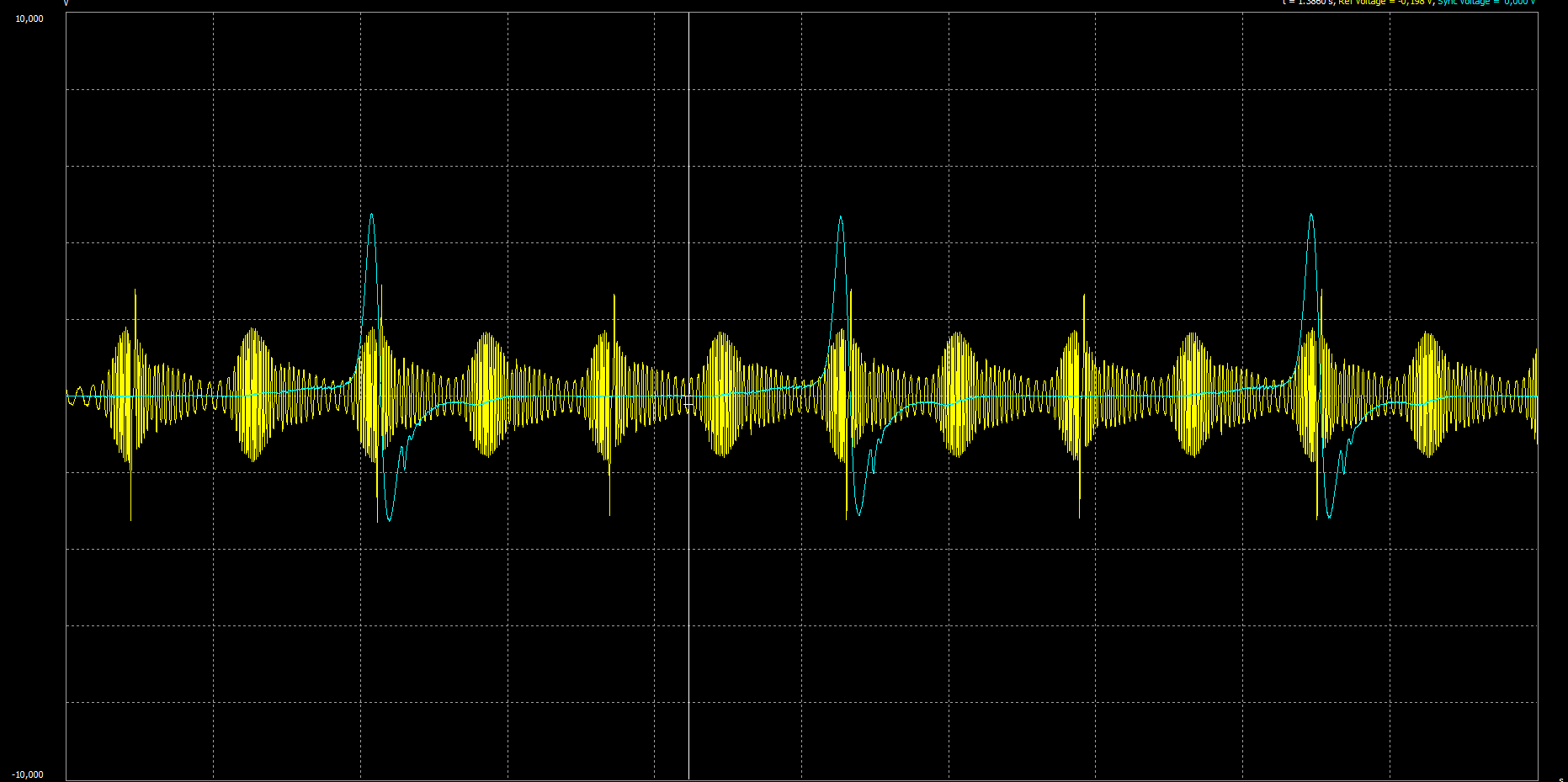

Postby eMTea on Wed Sep 25, 2019 6:30 am
Hi! I'm back!
The Norwegian Championship is over, and we now have time to reinstall the M84 and try startup.
Still no SYNC.
Please look at the captures attached.

Postby AdamW on Thu Sep 26, 2019 7:06 pm
Your sync edge (cam tooth) occurs right on top of the index tooth (crank tooth following the missing teeth), it needs to be well away from the gap. Preferably 180+/-70deg as per the help file.
You also have some odd noise or distortion of the waveform in a couple of areas of the ref/sync capture, but I suggest you get the sync edge in the right place first before looking at that.
